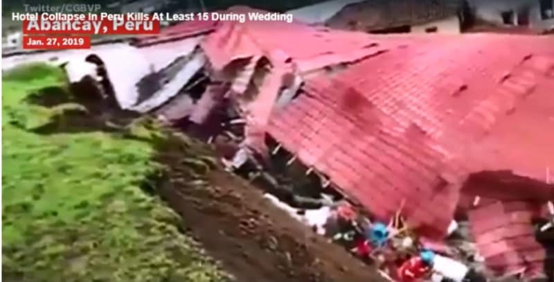

Jan 29, 2019 #6 hokie66 Structural Joined Jul 19, 2006 Messages 23,511 Location AU Reports attribute the collapse to a mudslide after heavy rains. Looks like the hotel was build into the hillside, and perhaps the roof was supported on the retaining wall which was moved down the hill by the slide. https://www.ibtimes.com/peru-hotel-...led-injured-photos-show-damage-rescue-2756715 Upvote 0 Downvote

Jan 29, 2019 #7 JAE Structural Joined Jun 27, 2000 Messages 15,712 Location US You can see a hillside "tear" in the grass above the hotel in this image...suggesting a rankine-like slope failure. Check out Eng-Tips Forum's Policies here: faq731-376 Upvote 0 Downvote

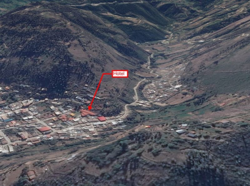

Jan 29, 2019 #8 JAE Structural Joined Jun 27, 2000 Messages 15,712 Location US A perspective on the hotel site - base of a large hill/mountain. Check out Eng-Tips Forum's Policies here: faq731-376 Upvote 0 Downvote
