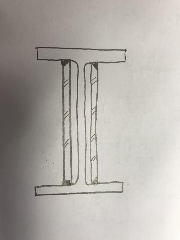

I have a situation where I have a W460 steel transfer beam that has undergone significant corrosion, to the point where the web is too slender to function (thickness testing is currently ongoing). Flange flexural capacity is still OK. Replacing this beam is almost impossible as it supports structure above, as well as beams framing into it. I've had the following thoughts on fixing this:
1. Add web stiffeners at the appropriate spacing to mimic a compact web. The issue here is that the web may well be too thin to weld to.
2. (more out of the box) Ignore the web entirely, treat the flanges as truss chords, and provide diagonal and vertical stiffeners (angles even) capable of resisting the forces in a truss analysis. This will require a bit of fancy detailing around the beams framing into... but I think it's doable.
Any thoughts about my ideas above, or other thoughts?
Add transverse stiffeners at the spacing required to meet the required shear capacity. If the web is too thin to weld, you can do angles on both sides and bolt them together through the web.
If substantial portions of the web are too thin to provide the shear capacity, even with the stiffeners, you may have to do option #2. For ease of construction, I'd recommend bolting back-to-back angle pairs through the web. Fillet welding stiffeners to the flanges will reduce the fatigue stress limit for the beam. If the cyclic load stresses are high, you may have to avoid connecting to the flange, use a bolted connection to the flange, or use full-penetration groove weld.

I was suggesting to put an angle on each side of the web and bolt the angles to each other. This will stiffen the web so that it doesn't buckle. If the web is too thin and could tear in tension due to the shear, then you will have to reinforce it another way, such as diagonals or supplementary plates.

To anyone reading this in the future, the NDT suggested an low-end web thickness that I could work with. I ended up adding bolted transverse stiffeners as per HotRod10's suggestion. Thanks for the responses everyone.
