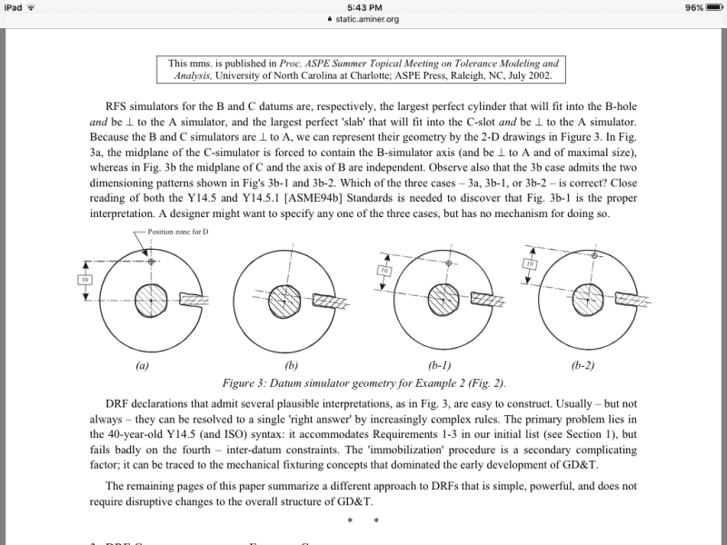

I have a dilemma: why 3b-1 is the correct interpretation?
Herb was making an argument in support of a means to distinguish the three cases. If he picked the first one, "a", there would be little motive to continue and "b-2" is unappealing to the cause.
I think any "b" case is not supportable. I don't recall anything from the 1994 version, which was applicable at the time, suggesting that the RFS simulator would change location and/or orientation relative to earlier references in the DRF. In fact, the opposite is true, with specificity that the centerplane in such an example remain exactly aligned - Fig 4-15, '1994.
There was no need to rotate the relative position of the hole that is being controlled in the diagram. If the diagram is redrawn with that hole directly vertical above the datum B feature, then the movement of the datum C simulator is clearly not expected.
Ultimately it's a case of "Can't sell a solution if you can't show there's a problem." It would have been trivial to state paragraph and figure to support b-1; not sure why he chose not to.
I believe Voelcker's argumentation for figure (3b-1) was coming from the wording of para. 4.5.3(d) in Y14.5M-1994 and from fig. 4-2 in Y14.5.1M-1994. The paragraph basically says that the tertiary datum feature simulator (called True Geometric Counterpart, TGC, in that version) must only be oriented to the primary and secondary TGCs. And the figure in the math standard literally shows that.
Unfortunately, figures in the Y14.5M-1994 standard (4-7, 4-9 and 4-15), as well as applicable figures in Y14.43-2003 for gages and fixtures, clearly show the center plane of the tertiary TGC aligned with the axis of the secondary TGC. So in short, before 2009 there was a conflict in the standards.
According to para 4.11.4(e) and indirectly to para. 4.5.2(c) in Y14.5-2009, in addition to basic orientation, the tertiary datum feature simulator must have basic location to the primary and secondary datum feature simulators. With that defined, there is no longer a conflict between the text and the applicable figures in the 2009 version (4-9, 4-15 and 4-18) of Y14.5-2009.
So if the discussed article was written after 2009, the correct answer would be (3a). If, however, someone wanted to override the basic-location requirement, the translation modifier for the tertiary datum feature would have to be used. And then the correct answer would again be (3b-1).

pmarc - with customized datum frames, per Voelcker, all three are available, which is exactly what he got into the standard.

I am not sure what you mean by "customized datum frames, per Voelcker", but I would say that in the Y14.5-2009 realm there is a way to specify all 3 cases from Figure 3 without using a customized DRF concept as defined in paras. 4.22 and 4.23.
Case 3a is simply |A|B|C|.
Case 3b-1 is |A|B|C[translation]|.
Case 3b-2 is |A|C|B[translation]|.
So in that context his complaints that designers don't have tools to define those cases don't apply any more.

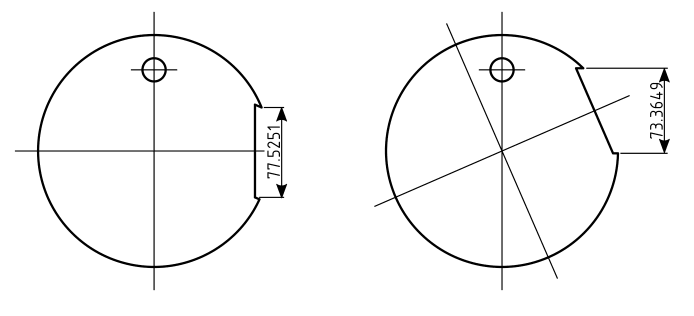

This is a diagram that shows the b-1 figure argument is carefully contrived to have an extra degree of control that is beyond being a tertiary datum control. b-1 depends on the tertiary datum being suitable, all alone, as a feature sufficient to provide reliable orientation control with minimal sensitivity for the part based on acceptable variations. So here's what happens when the depth of the feature is changed without changing the allowable variation; noting that depth is not mentioned in the tertiary datum argument.

If a feature by its nature (for example due to its size) isn't good candidate for a datum feature, then it should not be chosen a datum feature in the first place, because it will most likely not function as a robust datum feature in a real design.
And my apologies, but I have to say ask for clarification again... Could you help me understand what the diagram is showing?
pmarc - are you saying that detents for indexing don't work? Because the dents that are used for indexing cannot by themselves fix the rotation of the part.
It's as clear in this diagram as it was in Voeckler's paper and is just as good a candidate. I could drop a shear key into such a shallow notch and provide huge levels of fixity, even without leveraging against the bottom face. If a change in an unmentioned characteristic can cause the feature to become not a good candidate, then it isn't my fault that it was overlooked as a flaw in the original argument. That those making the argument went to the math standard and undermined the main standard was unfortunate.

Not to pile onto pmarc's question but could you also expand a little upon what you mean by the below? It seems to me that in many cases a tertiary datum will be able to have at least one extra degree of control beyond what it is technically "allowed" to constrain as a tertiary datum feature - and/or at least one more than is needed to constrain the part (technically over-constrained) which is the heart of the tertiary datum problem. I think the key is in what you mean by "sufficient to provide reliable orientation control with minimal sensitivity for the part based on acceptable variations" but I'm just a tad unsure what exactly what is meant by that.
3DDave,
What I was actually trying to say was that I didn't really understand the point of the argument you were making. And the diagram you prepared didn't help me to understand it.
For example, it wasn't clear to me why the dimension value on the left picture was greater that the dimension value on the right picture.
But you don't have to explain it to me now. I see the discussion isn't going in good direction, and I'm not interested in another tense debate with you that in the end won't help anyone on this forum.
pmarc - Had I shown my diagram at the time, it's very likely that the committee would have rejected datum mobility as the default interpretation for the Math standard. Instead they were shown a very special case with unstated assumptions. Understanding those assumptions is helpful.
