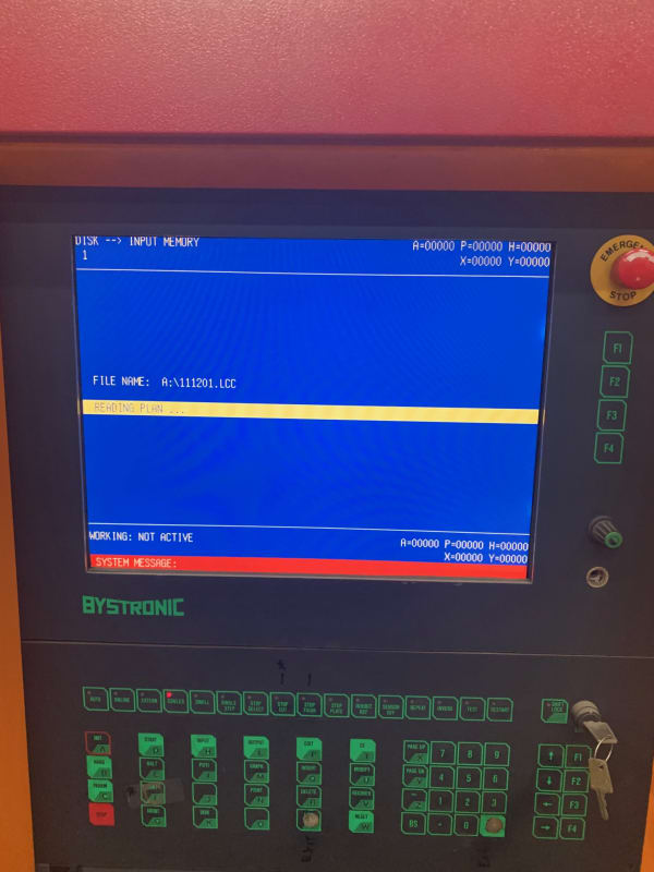

Hi guys I have an issue with my laser, everything was working fine, after a weekend, the computer start and I get the message cmos battery state low, it was doing it preveiously but I was going in the bios and exit without saving and everything was running normally. Know everything works, laser cut in manual mode, I Can load cutting parameter in the machine do everything except for one thing, I’m unable to load cutting file (.lcc) no error message the computer is just loading and loading endelessly, my USB reader work since I’m able to load parameter. I’m running cnc 90 with p5730 software. By speaking with bystronic I tried change ramprom card and sercom card and still get the same issue.

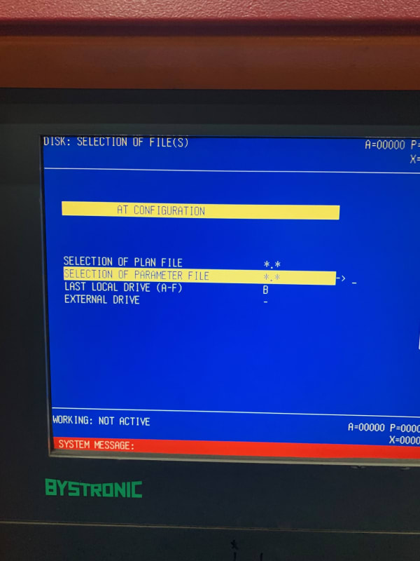

You need to replace the small button battery inside your computer that will get rid of one problem. As for the not finding your cutting plans you may need to tell it where to look for them again it's forgotten the pathway.

Actually I see my file on my USB key by hitting disk, but when it’s start to load it never end up in my cnc
It’s reading plan but never able to load it and no error message even after 5 min
When you say you need to tell it where to look for them, where I input that info?
Is it in that screen
Or in bios?

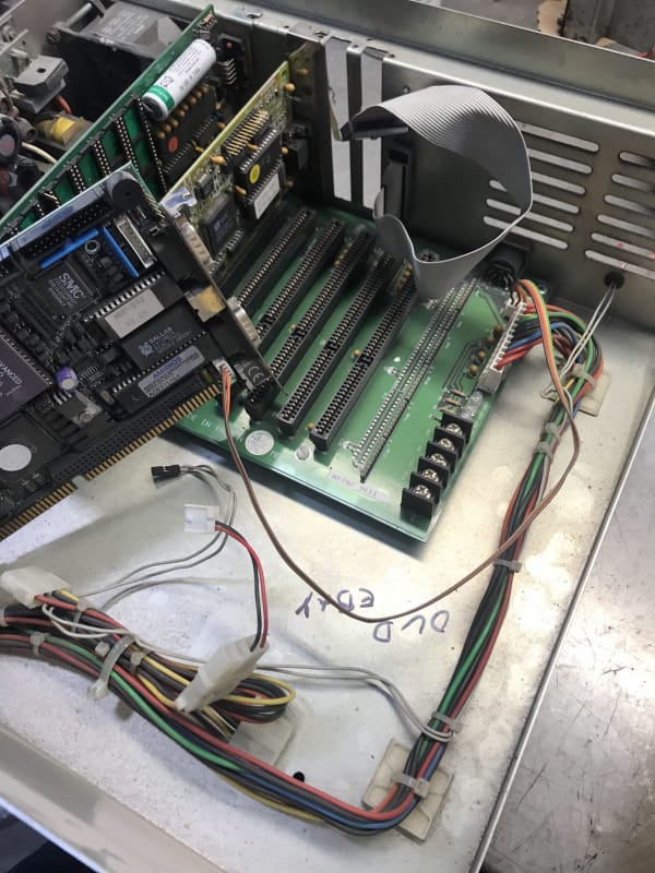

Also the battery that you where talking about is it that one
The white and green one or there is another somewhere that I missed, this one was change and still get the same message cmos battery state low
Jonathan, No the white and green thing is a capacitor. The battery you are looking for is a button battery like the one you would see inside a watch only bigger. About the size of your thumb nail.

If that is an actual battery and you can't find a button battery on the PC's mother board then it probably is the one. I just have never seen battery like that in a computer before. May be an old comp.

Update- Johnathan sent me his computer, I did some surgery to replace the battery that was embedded in the real time clock on the main board and also found some errors in some of his program files. I have a complete CNC90 rack at my house and I have a nice collection of parts.
