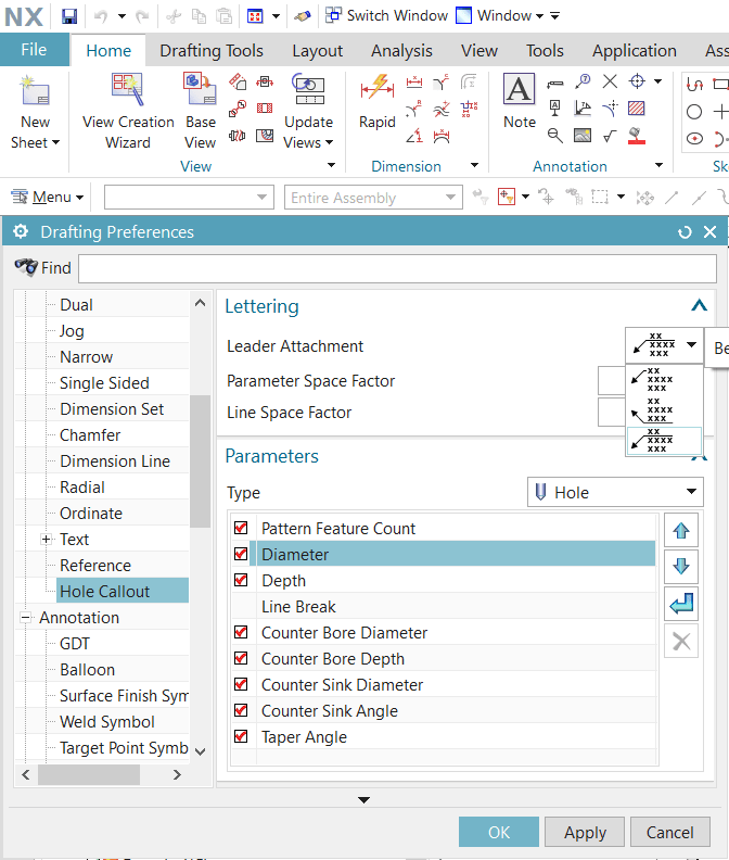

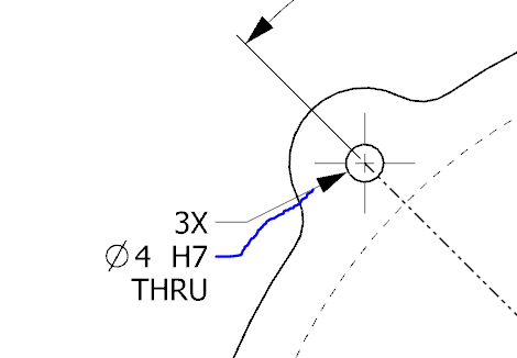

please see the below image of nx drafting,
1. in Hole callout dimension, how to orient the text after stub line (now its above stub line) as shown in rapid dimension option?
2. in inferred dimension option, how to orient that stub line exactly between upper and lower texts?
File > Preferences > Drafting > Dimension > Hole Callout
The leader type is in the top right corner of the preferences window

Preferences settings are not updated in the drawing. is it because these settings were not in the template? do i need to update the template for this?
Hi lgnx
Updating the preferences in your current Drawing will only affect newly placed dimensions. Existing dimensions will not update automatically. (would be nice though, maybe worth an ER at GTAC)
If this is a setting you would like to have in ALL your drawings, then it is best to update the template as well.

i am not getting that stub line middle to the text even after changing settings. i choosed third type leader attachment.
it comes like this below image. i want it at middle as in line i drawn.
