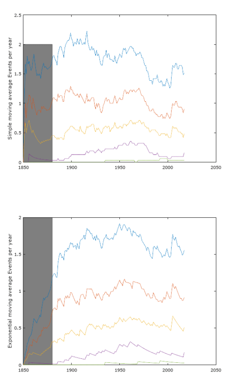

My question sounds fairly basic, but as statistics is not my strong suit I'm asking it here.
I have an event that happens irregularly over time, similar to, but not exactly like hurricanes. I know the time and date of each event, and thus the "time gap" between events. After each new occurrence I want to determine how frequently events are occurring, and thus if they are happening more or less often at that time. Then, after each new event, I'd update a graph and trends should emerge.
Do I use something like the exponential moving average (EMA) approach for an irregular time series to somehow calculate the average "time gap" after each new event, or is this way off? Another thought would be to instead use a fixed length of time and, after each new event, calculate the number of events per this fixed length of time to get a "running" frequency?
Funnily enough Hurricanes was my first thought. EMA is ideal for this. I'd use say 120 months as a first guess. That is,
f(t)=(119*f(t-1)+s(t))/120
where f is the ema and s is your time history of events. The advantages of ema over simple moving average f(t)=ave(s(t),s(t-1)...s(t-119)) is that it has calculable effects on the frequency response, and responds immediately to a spike at t even if there is a spike at t-120, and generally looks more like a real system. SMA is fine where there are a lot of events in the sample time, but in signal analysis it would be unusual to use a uniform weighted SMA - I'd only deliberately use it in strange circumstances.

I think "number of events per decade" or whatever is a pretty good place to start. EMA will handle that nicely, so would SMA. If you torture the data with some fancy techniques you might find a trend that a simple approach doesn't reveal, but if it doesn't pass some basic sniff tests you'd be hard pushed to justify it.
For example, were there the same number of hurricanes 1900-1950 as 1967-2017? if so then any trend in frequencies is pretty weak or inconsistent. If, as is the case, the answer is that there were fewer hurricanes in later years then torturing the data to find some increase in frequency would need to use some bulletproof method.
I've attached a somehwat cleaned up version of that data, showing decimals of a year and the hurricane strength.
Cheers
Greg Locock
Top line is cat 1 and higher, next is cat 2 and higher, and so on (Octave's legend box is cantankerous). The averaging period is 30 years. The greyed out section is the first 30 years. The exponential average is misleading in my opinion because it shows the effect of the zero data right through until 1950. These are trailing averages, that is the date is that of the last year in the average. Normally I'd shift the x axis so that the midpoint is used.
