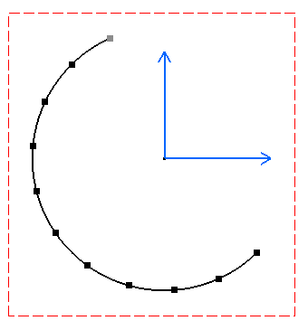

Any idea how I could take one Circle2D and simplify it with lines?

As input I have only arcs of circle, not full circles. I need only to simplify with lines this arcs of circle.
I am able to get from Circle 2D the radius, center point, start and end point but no more.
The question is how to create the necessary points only on the arc of circle and not on empty side?
Maybe I could create some equidistant points for complete circle (as told by itsmyjob) and next to check somehow which point intersects the Circle2D (arc of circle in my case).
Circle2D is just a curve, and all basic types (line, circle, spline, ellipse, line) seem to inherit methods from Curve2D. You can use Curve2D methods like GetParamExtents to get extents of a curve and then get points by GetPointAtParam method. Then it is up to you how you join them together.

Tesak, this was the first thing to try for me but unfortunately for Circle2D it creates the points on almost complete the circle, not only for my arc. It ignore somehow that my curve is only arc and somehow it takes the curve as full circle.
I am afraid you do not use parametric extents properly. If your extents are p(0) and p(1) and your iParam for function GetPointAtParam(double iParam, CATSafeArrayVariant oPoint) is between p(0) and p(1), then you get points only on a visible part of a circle. If your arc is divided in x = 10 parts, then you get other points with a loop like this:

For i = 1 To x
    iParam = p(0) + (p(1) - p(0)) / x * i
    myCurve.GetPointAtParam iParam, currPoint
    fact2D.CreatePoint currPoint(0), currPoint(1)
Next
What you get is shown below:
p(0) and p(1) are parametric equivalents of the end-points of a curve, points in between extents lie on a curve.
Tesak
- Text along a curve for Catia V5
Thank you Tesak, you are fully right, now it is working.
