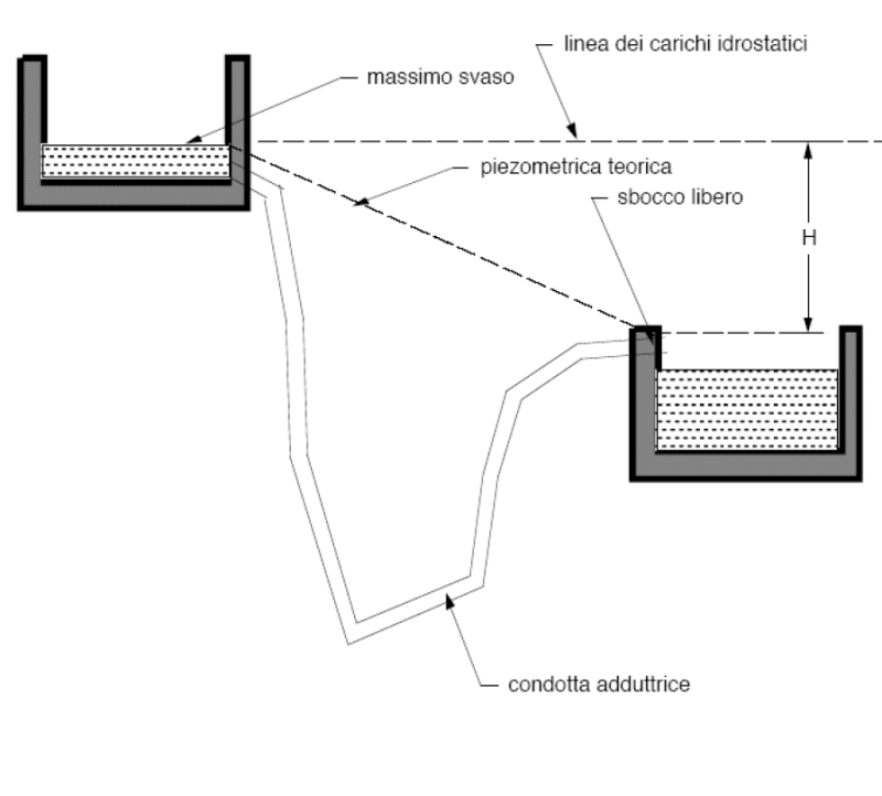

Hi everybody,
I have been given the task to analyze the behaviour of a storage tank with the predicted populaton at year 2048. Since it is the first time that I face such a problem I decided to try the free software EPANET to evaluate how the tank's volume changes in time(due to a demand pattern). I followed some tutorials to build a simple model with just one pipe connecting a reservoir and a tank but now I'm stuck because I need to mantain constant the Hydraulic Grade Line (so that there is a constant flow between the reservoir and the tank), because the actual pipe is attached higher than the maximum level allowed in the tank. As far as I understand EPANET builds the HGL always connecting the two water surfaces, is there a way to tell EPANET that the pipe delivers water higher than the tank's water surface instead of the bottom level?
I made this sketch to better explain the problem:
Thanks for your help, best regards.

My problem is that I want to assign a constant flow (flow in the day of maximum consumption) as input to the tank, and that is not influenced by the application of a demand pattern downstream. I mean that I want to model the system fixing the delivery height of the tank's gateway, so that the HGL in the pipe remains the same as Steady State Simulation, is there a way to do this?

I found a better image of the situation that I'm modelling: do you know if EPANET can represent this particular configuration?
Tanks again.

I think you should model a pressure sustaining valve at the inlet to the lower tank, and set the sustain pressure to the HGL of the lower end of the fill pipe. Connect the PSV to the lower tank with a short large diameter pipe. That should allow you to model the hydraulic performance of the supply pipeline, while preserving the performance of the lower tank.
As I understand the original problem in the OP, it seems fairly obvious that for the configuration labeled "What I need to do", the tank is irrelevant, as the outflow of the pipe would be unaffected by the level of water in the tank. It could be removed from the model, could it not? If the program cannot model a free outflow, presumably into a drainage ditch, or whatever, then it would appear to be worth about what you paid for it.
Producing a constant outflow, unaffected by the level of water in the tank, should be as simple as having the outflow from the pipe enter the tank above the level of water in the tank, restricting the outlet size to the proper cross-sectional area based on the hydraulic head and losses within the pipe. If the pipe enters the tank anywhere below the water level, then where it enters is irrelevant; the hydraulic head is still the difference between the water surfaces in the reservoir and the tank. Friction losses within the pipe aside, it makes no difference where the pipe goes between the reservoir and the tank either, unless it rises above the level of water in the reservoir and it is not kept as a closed system.

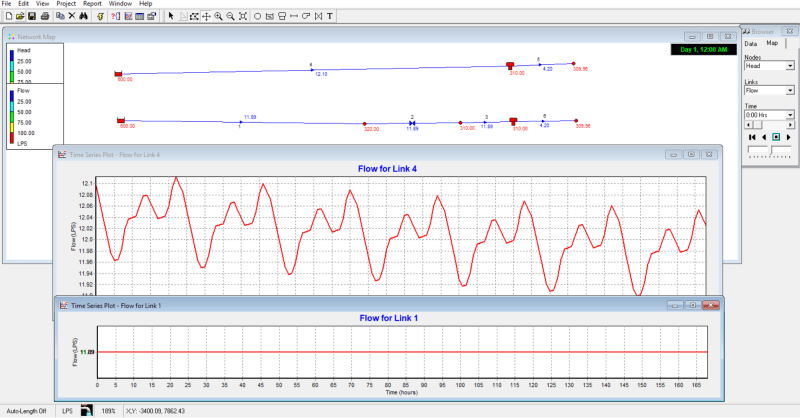

Thank you so much 77JQX, you put me in the right direction, in fact “PSVs maintain a set pressure at a specific point in the pipe network”.
I haven’t tried on my project yet, but it worked perfectly in this example below, setting the PSV valve to zero and its upstream junction’s elevation equal to the discharge elevation: it is like the inlet is above the water surface: with the valve a constant flow reaches the tank during all over the simulated period.
