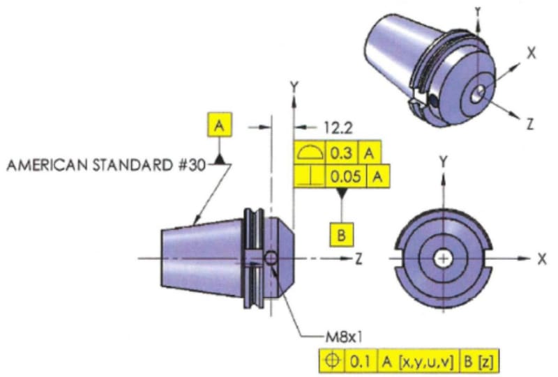

Here's a good application. Without customizing the DRF, that hole would have to be located axially from the apex of datum A.
John Acosta, GDTP Senior Level
Manufacturing Engineering Tech
Wow, that’s a small picture. I’ve tried to blow it up, but become blurry.
Here is the big picture, snapshotted from "The GD&T Hierarchy" by late Prof. Don.
Season
I suppose we will be left to guess the need to dimension from a non-interface surface and the lack of a diameter symbol in the tolerance section.
Thank you Season. I did not know the picture is from Tec-Ease training material.
One comment I have about this picture: profile withn 0.3 to A is not needed. Only perpendicularity within 0.05 to A will suffice.

3DDave - as well as the lack of basic dimensions for both the hole and relative location of datum feature B to A.
greemini - why is profile not needed? I thought this was the one thing missing from the original (small) figure. You need some way to locate that face to datum feature A, right? Maybe you could link to the video, I'm interested as to how perpendicularity alone would locate datum feature B..
As far as the original question, I would agree with CH a custom DRF would mimic a "floating" assembly pretty well. With rigid components, I think maybe it gets you closer than perhaps a standard DRF would but I think there would be quite a bit of actual sharing or changing of DOF constraint between the datum features with even minute changes in tolerances and assembly forces (even with pmarc's caveat that the tolerances would be held such that they wouldn't - I am wondering if that would even be possible). Maybe thats good enough though to say it would be a good candidate for custom DRF?

The vertex of the cone should have a dimension to locate what is identified as datum feature B. I suppose 'this drawing is incomplete' applies.
May I ask you why is that? Could you, please provide more details?
The cone vertex is the only invariant location on the cone. Some substitute a gage diameter to find some other location, but that just adds another step. Without this dimension the surface is left without a defined location.
Still not convinced.
I would say you locate anything else from it you don't neccessary locate the cone. Am I missing something?
Yes. I said the surface used as B needs to be located from the cone vertex. Perhaps this word order will work.
