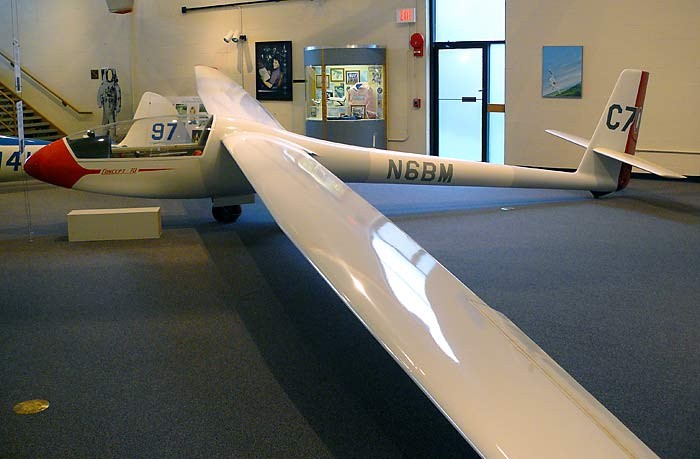

Is this one of yours, perchance?

Sparweb,
It looks like I am being exposed. The ship in your picture is serial #6 of 21 fabricated in the USA. That ship was made just before I started with the company. I worked on or built the aircraft following that one. I also repaired that one ( #6) after it had a close encounter of the wrong kind with a fence.
I also have about 10 hours of flight time in that bird.

Sparweb,
I sent you a reply .
You realize that the picture you posted was taken at the Harris hill soaring museum, and that aircraft is now literally a museum piece.
What is even scarier is that apart from some refinement in materials, the methods and techniques used to produce that type of aircraft have not changed in 44 years.

Yes, I found that photo on the museum's collections website. If I'm ever in upstate New York...
Flipping up the full-span flaps into spoiler mode but have been a pretty dramatic event.

Sparweb,
The flaps don't work that way. They will go negative but only _5* . however for landing they come down 90*. Stall speed with the flaps down 90 is 22kts. and with the nose pointed down at 45* you will never get over 55kts . Putting the flaps negative at high speed brings the nose back up so that you do not look like you are diving into the ground. It also gets the fuselage back in line with the airflow reducing the fuselage drag. In the attachment there is a picture of an approach of a C70 with 90* flaps deployed. That's me driving that thing, that is a stabilized approach at 50kts indicated.
