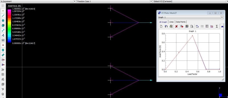

The above method of using a CBUSH1D with a brittle failure force-displacement curve should work (I have tested it in Strand7 and it is OK. Below an image of the cutoff bar elements at the bottom with failire at 1 N and at the top 3 spring elements like CBUSH with a nonlinear force displacement curve for brittle failure; reults are almost the same, red and blue graphs show axial force in the failed cutoff bars and spring elements respectively).

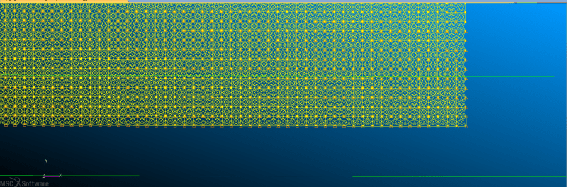

What I am trying to simulate is an abrasion phenomenon, studied through the principles of the peridynamic theory: it is part of a project that wants to reach an union between this theory and the FEM method, and considering the abrasion, this kind of investigation is quite new. As it can be seen in the image the structure looks like a quite intricate truss structure which connects many points. The aim of the simulation is to reproduce the abrasion, that is the failure of some truss due to the friction with the plane over which it is dragged (green lines are part of the surface that originally acted as the rigid plane).

So, if I am interpreting the view correctly, the truss structure is perpendicular to the rigid plane, right? I am also interpreting that the lowest row of GRID points in the view are all in contact with the rigid plane. Now you apply some loads somewhere which tend to cause the truss structure to slide across the plane, and you want to know if, and where, the structure fails (exceeds some nominal load value - hence the fuse).
If this interpretation is correct, what pushes the truss structure into contact - in other words, what sort of load develops the loads normal to the plane from which friction forces will emanate? Gravity, some press type loading?
DG

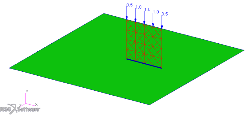

Here is a small example of a truss type structure connected by CBUSH elements. The structure is placed on a rigid plane on its edge so it is normal to the rigid plane and just touching it along one of the edges of the truss structure. Along the edge in contact, CBAR elements are also connected to the GRID points, but these CBARs have a small section dimension and low value Young's modulus for their material. The goal of the CBAR elements is to provide the geometry for the contact with the rigid surface. The top edge of the structure is fixed in the Z direction as a guide and prevents the structure tipping over.
Step 1 applies a vertical load to push the truss structure into contact with the rigid plane. Small value linear springs are used to stabilise the model, as there is a rigid body mode in the X direction until load develops at the contact surface and friction stabilises the problem.
In a second step, the GRID point at the top left of the truss structure is then loaded in the -X direction to pull on the truss structure. As the load is increased, eventually the loads in some of CBUSH elements of the truss exceed the limits defined by the FUSE levels. This occurs somewhere between load factor 1.7 and 1.8.
