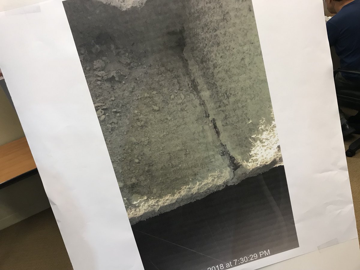

Wider inspection has discovered a second cracked beam. The beams are in an area that appears to be part of the terminal that spans Fremont Street. What side of Fremont St. is not yet known. SalesForce Tower is on one side of Fremont St, and Millennium Tower is on the other. News: Link
Locale:
Link
Link
Crack 1:
Link
Crack 2: With Fireproofing
Link
Skanska won the Steel Supply & Erection Contract.
Link
Steel Erection crossing Fremont Street
Link
Miscellaneous Steel Erection Photos:
Link
Link
Link
Adjacent to Millennium Project
Link
epoxybot,
Are you the mayor, chief engineer, attorney general, chief of police and head librarian for San Francisco by chance? Star for you again.
Concerning crack for certain, looks like stiffener/web/flange interface origination as HotRod10 speculated.
IC
That is a scary looking crack. How much life is left in that beam if the tension flange is gone....

It looks like a lot weld in that section so may be weld shrinkage cracks? The area close to the weld would have reduced fatigue allowable as well but the structure isn't that old so it doesn't seem like a roof area would get a lot of high cyclic loading.
I reminds me of a torn clip angle I saw recently. I can't be sure but I think the tear happened when the structure experienced a shock load from an explosion in another part of the structure. I wonder if there was some shock to the tower? Maybe a dropped load of material?
Finally, one article mentioned the same crack at two beams – so maybe bad detail at the connection resulting in high weld shrinkage stresses. If that is the problem they would need to make some remedial repair to every location with the detail.
