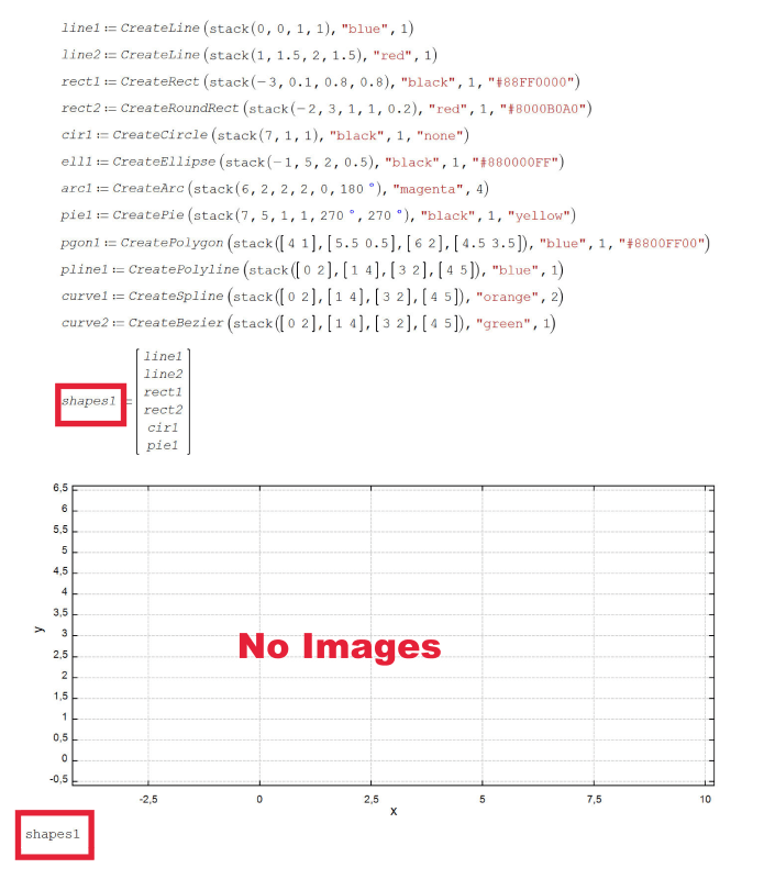

Thanks IRS... been on the yaf... that's where I gleaned the posting... I have XY Plot loaded as a plugin, but, if I try to load the program, the graph areas are blank.

Can you send me a *.sn file? I cannot even get the one on the site to load properly. What tweaks? According to the limited documentation, the plugin should load vectors... all data types are vectors.

IRS: still doesn't load. The path to the plugin is:

Oh, did you use the Tools | Plugins | X-Y Plot Region to do that? It should have all been automatic; the program downloads the plugin from the SMath wite and installs.

I'm going to uninstall and re-install... Doesn't allow me to delete it... going to re-install SMath...

IRS:
Finally got it working... pretty slick... now to check variable names in plot to see if I can assign a variable to the name... else, I have to pick a scale and scale data.
I uninstalled the program,
Copied all my desktop files to F: drive
Erased all Drive c: with 'SMath'... there was a bunch
Scrubbed the registry of 'SMath'
Reinstalled the program
Installed plugin for XYPlot Region...
and it works... to reiterate, pretty slick. Thanks for the assistance and support.

Not done yet. I tried to isolate the circle and line parts without success. The image shown should work, but, for some reason doesn't. I've attached the actual *.sm file.
Any suggestions? There seems to be a 'disconnect' with the vector name.
