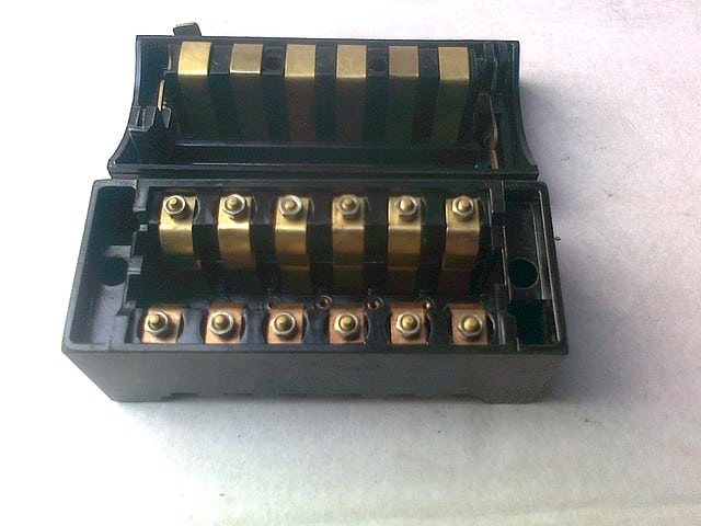

We use these TTB. It's old but reliable :)
