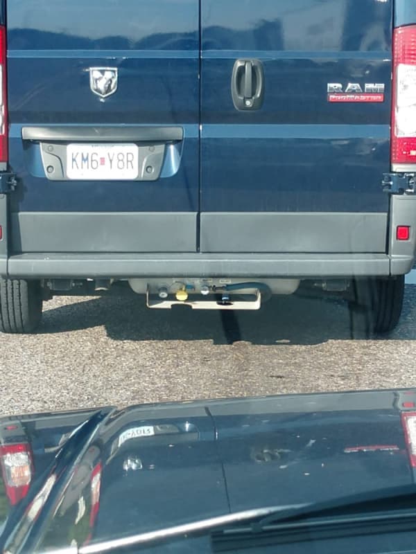

That's obviously aftermarket. Company van is the same model - that aftermarket propane tank is placed where the original spare tire was. They probably thought about ease of refilling, but not what happens if they get hit from behind ... or back into a kerb.
People doing aftermarket stuff to their vehicles, don't usually go through a FMEA process with whatever it is that they are doing.

I agree that is about the dumbest place you could put a propane tank.

As opposed to putting it where, inside the passenger compartment?

It will fit under-floor just as easily ahead of the rear axle as well (front wheel drive van, so there is no driveshaft up the middle) but it will not be as easy to refill. And you would be able to keep the spare tire by putting it there, too.
The van's original fuel tank is under the floor roughly under the driver and passenger seats.
"As opposed to putting it where, inside the passenger compartment?"
If it gets punctured, it won't make much difference whether it's under the back, under the middle, or inside; the results would be the same. However, that's much less likely to happen inside the frame between the axles. For the most part, outboard and in-cab gasoline tanks have mostly been done away with for the same reason. That said, I still have a '69 Chevy 1/2 Ton with the gas tank behind the seat.
I am used to seeing propane tanks mounted under the body on the right hand side, about center.
This location does not invite the Pinto effect invited by a rear mounted tank.

HotRod10, I remember my '72 Ford PU with the tank behind the seat. If I recall correctly there was some issue with Chevy's tank once they started put them under the bed, outside of the frame rail.
You bet David; training one member at a time.
Between the axles... Remember the F150 debacle? Every time one got broadsided it was BBQ time because the underslung saddle tanks took it.
Though in fairness gasoline tanks are thin weak things compared to propane tanks.

"...there was some issue with Chevy's tank once they started put them under the bed, outside of the frame rail."
Yeah, a number of those outboard tanks were punctured by minor fender-benders and even big rocks. The new plastic tanks are quite a bit more resilient, but I think all OE tanks are now mounted inside the frame rails.
