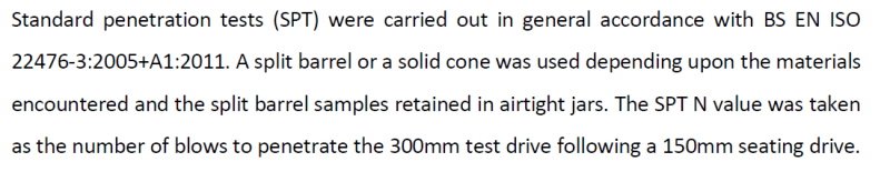

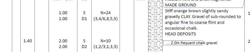

In the UK it is typically presented as blows per 6 no. 75mm (3") readings - The first two 75mm readings i.e. 150mm (6")is you seating blows and then the sum of the blows for of the remaining 4no. 75mm (3") = total number blows per 300mm (12") is your SPT N value.
The SPT cone is driven for a total length of 450mm (18")
See below example and an extract from our standard report.
