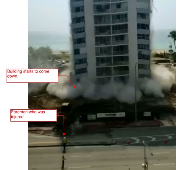

The building that collapsed at 5775 Collins Ave. was the 12-story Marlborough House, which was scheduled for demolition to make way for a new condo building, according to The Next Miami, a news site focusing on real estate.
Police said there was a demolition permit on file for the site, but not an implosion permit. Demolition refers to the general process of tearing down a building, while implosion is specific to the use of explosives to quickly bring down a structure.
I'm interested in why the paper did not also include "annihilation - the use of tactical nukes to vaporize a building." Maybe it was vocabulary day in the press pool.
I wonder if someone earlier in the process asked "Is this structural?" and got the answer "Naw, just cut it."
That looks like an intentional collapse; there's at least a dozen people standing around all looking in the direction of the building it collapses. It looks like a bulldozer or something similar is pulling on some cables just before the collapse. The street on the opposite side is clearly blocked off in the second video on that page.

Crazy how slow the guy is to react to the huge building collapsing.
His buddy nopes out of there real quick while the other dude sits there for a second.
Very sad, but RUNNNN damnit.
The equipment had a chain/cable pulling on something when it all came down. You can see it straighten up and lift off the ground.
The injured man certainly didn't look like he expected the building to collapse, standing so close to it - even after the structure began to come down.
He appears to raise his arm in some kind of gesture before beginning to run away.

It looks pretty intentional to me, there is a hose spray going on and many people lined up on the pavement watching it.
I suppose in essence this wasn't an implosion as there were no apparent explosives involved, but that D9 pulling a central support down.
I think the main building structure collapsed pretty well as intended, but what looks like the central stairwell or lift shaft was a bit more solid and suddenly stands proud of the rest and tips part of the building into the road.
Standing that close does seem nigh on suicidal though.
I get the impression that the contractor thought it was going to be a walk in the park. The updated article states that they had issued warnings to neighbors that demolition of building was to commence yesterday morning, so...

Expecting the collapse or not right at that time, they were doing something pulling with the dozer that was questionable enough they had left the building to watch it happen at a distance.
It also appears they were expecting to eventually drop the building like that based on how the bottom floor had been demolished down to the pillars while the other floors were more complete.
Certainly looked like a "planned implosion", sans explosives. Whatever it was that hit him, his hard hat sure went flying. Any news on his condition?
In a separate video there is a small chunk that hits his leg and spins him around, followed by what looks like a 3ft by 3ft piece, probably concrete, that sent him flying across the road. It looks like it hit him even with the shoulders on down. I'm a bit surprised it didn't kill him.
Rapid collapses generate truckloads of kinetic energy. I recall seeing a video of an implosion where chunks flew by bystanders that were supposedly at a safe distance. While our skulls are hard, they are not impenetrable.

Long ago, I worked for a dump-truck company that did a fair bit of demolition like this.
They probably wouldn't have done this job due to the tight surroundings.
But, if more open, weaken it at the bottom and pull at the top.
There was a lot of judgment involved, but NO actual engineering.
So not surprising that something could be done like this, or that it could go wrong.

A few sequenced clips from the video
