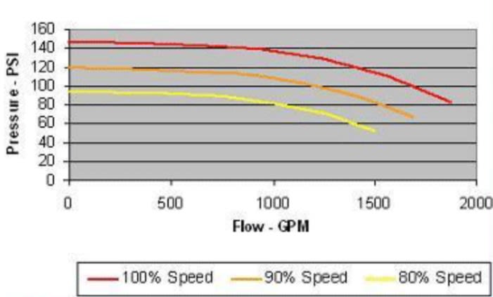

Hi all,
I am troubleshooting an old diesel driven fire pump (sprinklers) which is giving less pressure boost at 5600 l/min than it used to.
In 2009 it produced 5600 l/min at 680 kPa at 1900 rpm, but in 2018 it produces 5600 l/min at 540 kPa at 1900 rpm.
Talking to a diesel guy, he says maybe the diesel has lost the torque it used to have (installed since 1980 Ford Leyland).
Which sounded logical - but would that not mean in 2018 at 5600 l/min torque load the rpms would decrease below 1900rpm because the torque is not there from engine to keep the revs at constant 1900 rpm?
Instead the revs are constant but the boost pressue is not - sounds to me more like to pump impeller is the issue?
Because the pump is still getting the 1900 rpm but not putting out the boost (impeller is always same).
This sounds right?

Please post the manufacturer's certified pump test curve. It should look like this:
The pump should be operating on the performance curve. If the diesel was operating at the same RPM's and all hydraulic conditions were the same, you should be getting the same flow. The output pressure of a centrifugal pump varies with the square of the speed. Pressure can be controlled accurately by controlling the speed of the pump. By adjusting the speed as the flow changes, the discharge pressure of the fire pump can be held constant for any flow.
The hydraulic conditions need to be verified. Are the hydraulic conditions such as water supply pressure the same as when the original test was done?
How much usage does this fire pump set have? In the event that you do have a fire and this fire pump set breaks down, a reasonable person would consider operating a 35-year old pump suspect.
Same flow at difference pressure at same the speed on the same system doesn't make any hydraulic sense. Have you checked the pressure guage?
Hi Guys, thanks for reply,
We change the system load by opening closing the valve to get 5600 l/min.
Thing is, it should be able to put out 5600 l/min with a discharge pressure of atlesat 550 kPa as it was designed.
This is so the sprinklers are getting the pressure they need downstream.
The pump comes stright from a 1m high tank and there seems to be no restriction as suction pressure only comes down to -5kPa. Which is negligble.
The original pump curve shows the 550 Kpa at the flow could be reached with about 1870rpm.
There is another primary fire pump off the towns main so redundacy there.
I am quite confused how it was putting out 680 kPa in 2009 actually as the pump will need to be at much higher rpms to achieve that - maybe some of this data is bad..
But I think I can rule out the diesel engine as it still gives 1900 rpm when things were good and now when things are bad..

The pump at dead head (no load) sits at 2000 rpm.
When the valve is opened up to allow flow the pump suddenly needs torque applied by the diesel to do this.
the torque at 2000 rpm is not enough so it slows down to 1900rpm where the torque is enough.
Same goes if the torque was lacking due to a worn engine - the rpm would need to lower even further for more torque to drive the load.
So I suppose firepumps always want to run in their power bands, max torque to max power.
However in this case the rpms always remains at 1900 rpm so I suppose torque is enough but the pump is not..

After 35 years of doing that I think if you pull the pump impellor, you will probably find out it isn't quite the same size as it was when it went in....
I tried once to make this test have at least have 15% of rated flow and got completely ignored because their design was "certified" by UL or similar and they wouldn't change a single thing.
Here in New Zealand we have our own Sprinkler Standard - but if our standard is missing something we look into NFPA clauses.
To test our pumps every week we run them through a test return line back to tank or recirclation line with orifice plates sized to induce the pump duty. Orifice plates should be sized to induce 110% of the duty flow.
However I have seen some testers just run them against dead heads. I have also seen them run the pumps through a test return with no orifice or back pressure so the pump tries to run way off its curve. I'm quite new to this industry and it is quite rough n' ready.
So for this site, the tester has been running the pump at like 180 kPa (no back pressure) at 1700 rpm so it is way to the right of the pump curve. Must be putting out a lot of flow too.
So I will be installing an orifice plate to replicate the pump duty.
The pump itself looks to have been replaced in 1996. But that is still 22 years.

So 20+ years of running way to the right of the curve, possibly / probably cavitating for 30 minutes a week?
Like I said - pull the pump impellor and have a look at it. If it's all there I will be very surprised.
but you're right, the way the fire protection industry looks at and treats pumps is not conducive to long term good operation, but I guess they work on the principle that it only needs to work once. Trying to modify it though is like trying to re write the Dead sea scrolls...
