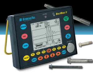

Along these lines there was a company across the street from where I worked called StressTel. They had an instrument for tightening bolts accurately regardless of washers, oil, contaminants, compressing clamp materials etc.
StressTel bolt stress measurement instruments ultrasonically measure the elongation of installed bolts and fasteners. Ultrasonic measurement of bolt elongation determines the true bolt stress and is often used when traditional methods are limited by unpredictable operational variables such as friction and lubricant.
StressTel offers two types of bolt stress measurement instruments: the full featured BoltMike SMII and the handheld Bolt Monitor with easy-to-interpret display. Both units are portable, easy-to-use, battery operated, and self-calibrating.
I always thought something like this would allow one to never over-torque a fastener.
