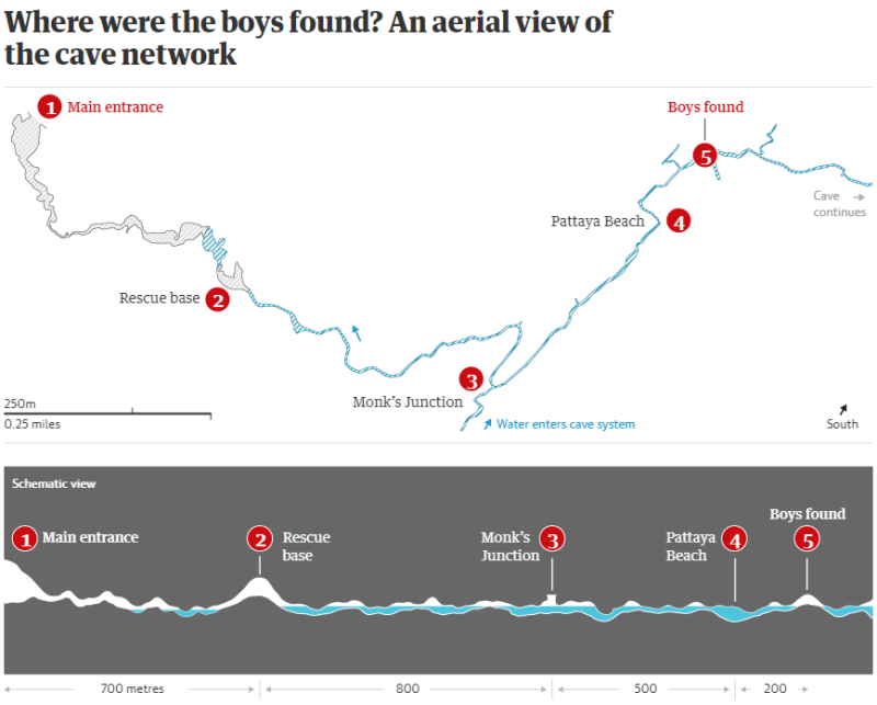

Long tube... they are in about 4 km... and I guess part of the journey, they may need/have climbing equipment... some areas are tight and may not be accessible wearing SCUBA equipment. Still tricky.

In the diagram from it looks like the longest stretch is 200m. It looks like the need to get 1500m to get to the main base before the final pool.
Even if the entire trip can't be made that way, limiting the amount of underwater diving would be hugely beneficial.

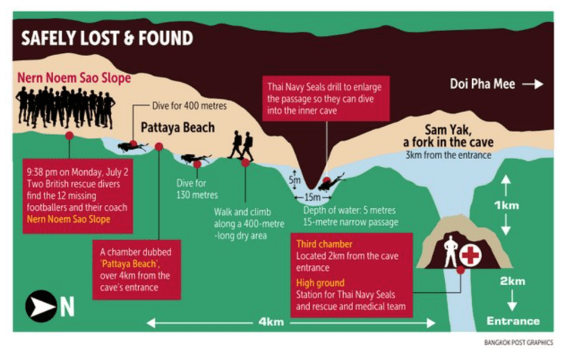

There is another diagram that looks to be drawn by someone at the site that shows that the current total submersion is only required at four locations for a distance of 30 feet each. That's not too bad and maybe is why they are going for the face-masks right away (aside from the impending monsoon season.)
There aren't many pictures of the whole cave and it doesn't seem to have been previously mapped in detail. Those showing the entrance suggest that parts of it are large enough and the passages must have seemed easily passable until the water rushed in.

Here is a more stylized graphic showing the situation in the caves:
Perilous exit dive only way out for boys
Coming rain may force boys to swim for safety

There are full-face snorkeling masks now readily available, i.e., Costco, and definitely available from manufacturers in China. The full-face masks makes it so easy, even for noobs like me. If the snorkel tubes are connected to an air supply, it might work, but 400 meters is a LONG way underwater.
