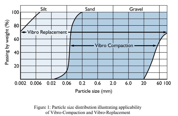

I have the task of suggesting a suitable ground improvement/reinforcement method for onshore wind turbine foundations with known dimensions according to a specific soil type and its properties. The methods I study are piles, micro-piles, rigid inclusions, stone columns and vibrocompaction. I have to make a software guide where the user must insert values as input and the output should be the suggested technique(s). My problem is that I am unsure of what input values should I look for and how to connect them to a specific technique. The soil properties are given from a pressuremeter test. During my research I found out that the grain size is important when it comes to selecting a technique. However, I am sure that the Menard modulus, the limit pressure and maybe some other parameters that I am unaware of are important too. I have read multiple geotechnical reports but the authors just give a method, they don't explain why they chose this method. I would be very grateful if some of you geotechnical engineers out there could help me because I feel a bit lost.

Grain size is important when assessing stone columns and vibro-compaction.
Stone columns work best in soft clay. Cu from 5kPa to 50kPa.

@PEinc I know this site. I found it during my research. However, I was wondering if the selection is applicable for wind turbine foundations? When I was reading the information on it I thought that the selection is suitable for road/railway application only. It would be great if you could clarify that for me.
