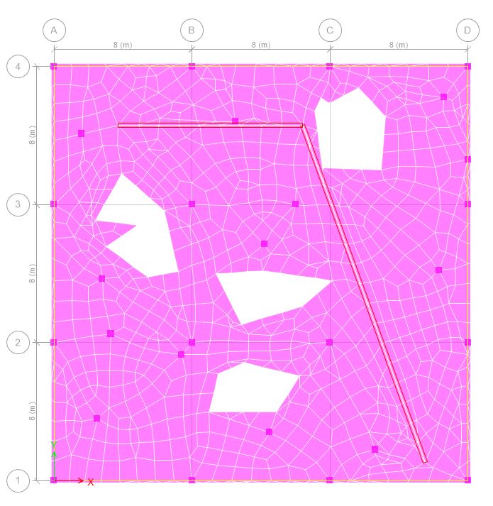

ETABS v17 - No More RAM Concept Floor Meshes?
Trenno
Feb 5, 2014
831
AU
Have CSI finally realised their meshing capabilities were sub par? Very keen to test this out. I assume they've replicated the SAP mesher into ETABS.
[URL unfurl="true"]https://www.csiamerica.com/products/etabs/releases
[/url]
I hope so! Color me excited.
As you mentioned, CSI's meshing options have always felt like the weakest point of the programs features. I always have to end up hand meshing items in CSI programs, as the auto mesh options always seem terrible/crashes completely.
After a brief test of the new version, I'm actually quite impressed with this new meshing capability.
The default option is such that the mesh automatically updates for each floor when you have the model unlocked and move a column or introduce an opening.
Haven't tried it on a big model, but the speed seems to be pretty sharp.
I haven't totally been impressed by it. It doesn't bake the mesh into the FE model. To be honest I have tried to extract point results output from the automesh. This can be a bit problematic.

I must say, I may have got my hopes up too soon. From what I understand the user isn't able to specify the mesh element size.
