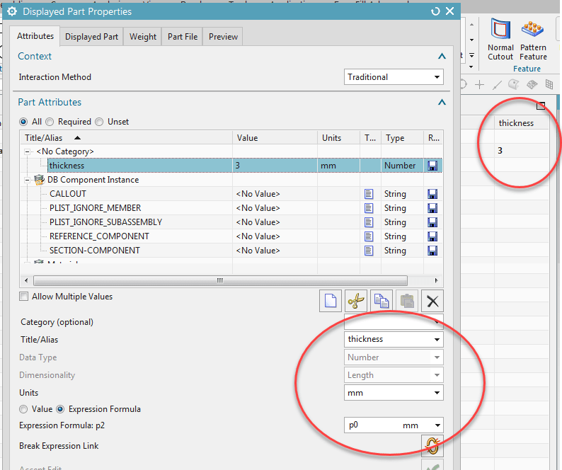

I've got the assembly navigator customized with adding collums of attributes which added to my templates.
When I want a new part expression (of child component) shown in the assembly navigator how can I do that.
I want to show the standard epressiong "Sheet_Metal_Material_Thickness"
I have a assembly which consists of 20 SM parts and want to check if all thicknesses are the same...

You probably need to link the expression to an attribute.
I assume , by your post above..., that the assembly navigator only can show attributes, not expressions.
the sad part is that you need to open each SM part and create an attribute "xxx" which reads this expression.
This can be done using a Journal.
