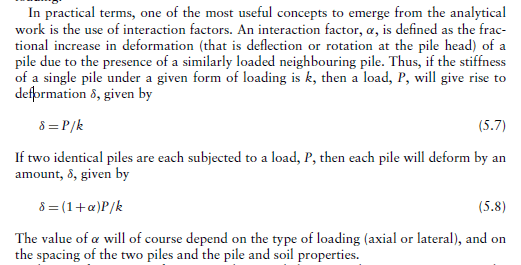

I am now looking pile group settlement. From my research, settlement of pile groups are larger than the settlement of a single pile due to the load shed from adjacent piles. I am using Piling Engineering by Flemming et al. as my reference. I have looked at two methods for assessing pile group settlement.
1 - Randolph and Wroth (1979) proposed the method using the α interaction factor, see page 189 and 190 of Piling Engineering. There is a αs factor which is the interaction factor for shaft and a αb factor which is the interaction factor for base.
The sum of αs and αb is then multiplied by the settlement of a single pile. Based on a pile length of 4m, 0.3m dia, and spacing of 1.75, I get a total α of 1.3. Therefore if my settlment for a single pile is 20mm then pile group settlement is 20x1.3 = 26mm. This method takes no consideration of the amount of piles in the group.
2 - Butterfield and Douglas (1981) , i think, proposed the decreasing stiffness method (see page 191) of each pile due to interaction effects is by means of an efficiency, ηw. You calculate ηw then multiply it by the calculated single pile settlement. ηw is essentially the number of piles to the power of 0.5. i.e. If you have 6 piles, ηw = 6^0.5 = 2.45. If you single pile settlement was 20mm your pile group settlement is 20*2.45 = 49mm.

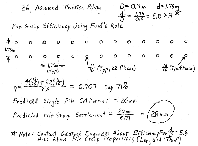

UP830 - Here are my calcs for the assumed 26 friction pile group you described. I get 28mm predicted settlement for the group, compared to 20mm for a single pile.
Have included a note on the calcs; would want to talk to a geotech about the soils since pile spacing d/D = 5.8 is pretty far apart for significant group action. Also, since the pile group is long and "thin" (13 piles long x 2 piles wide), would want an opinion on how that could affect group action.
IMHO, these two factors may?? make group predicted settlement a little less than 28mm.
Note: A readable .pdf of the calcs is attached.

UP830: to extend the interaction factor (α) approach to more than two piles, you need to do these calculations for each pile affecting every other pile (i.e. generate a matrix of α values). You might get a different (softened) response for each pile. If you have a pile cap or other pile head fixity, it is normal to take the average response of all piles as the pile group response.
SlideRuleEra (and UP830): I'm not familiar with the method(s) you are using, but it seems of that the efficiency factor (η) is being conflated with a softening factor. The efficiency factor affects the capacity of the pile group whereas the softening factor increases the settlement for the same applied load. A reduction in capacity is not necessarily equal to the reduction in stiffness.

Okay, that confirms it: you are applying an efficiency factor (which should be used to calculate the reduction of single pile capacity in a pile group) to the load-displacement (stiffness) response of a single pile in a pile group. This is incorrect: you cannot use these efficiency factors to predict pile group settlement. Capacity and stiffness are different and pile group effects affect them differently.
As an aside, but related to the above, if you have t-z or p-y springs in a structural model and you want to apply pile group effects, you need to be careful not to compound the spring softening. Moreover, sometimes if a t- or p-modifier are applied to a spring, that will also soften it; this should be avoided, with the pile group capacity reduction essentially 'cutting' the spring at the calculated value, and the spring softening handled separately using z- or y-modifiers.
LRJ - Thanks, in the your first paragraph I see your point.
How large an error will combining combining stiffness and capacity introduce?
Using my understanding of the OP's example, I got 28 mm of settlement for the group compared to 20 mm for a single pile.
Would a better answer be, maybe... 24 mm (half my estimated differential settlement)?

...the efficiency factor (η) is being conflated with a softening factor. The efficiency factor affects the capacity of the pile group whereas the softening factor increases the settlement for the same applied load.
Just realized my calcs are for friction piling (and are clearly labeled as such). There is no point bearing. How does a softening factor affect pile skin friction? For driven displacement piling in a group, soils in the vicinity are densified.
For cast-in-place piling (which may not be practical in soil where friction piling are needed) how does softening even apply?
Note: Not arguing... trying to learn something.

The error of combining stiffness and capacity reductions will depend on the magnitude of reductions as well as the formulation of your load-displacement response (e.g. type of t-z/p-y curves, etc.).
The 28 mm you got was from using an efficiency factor. To reiterate: you cannot use this approach to predict pile group displacement; it is a pile group capacity reduction method. Also, I have not said that the 28 mm is incorrect due to doubling up on the efficiency/softening factors: you've only used the efficiency factor and that is not a valid approach for predicting settlement.

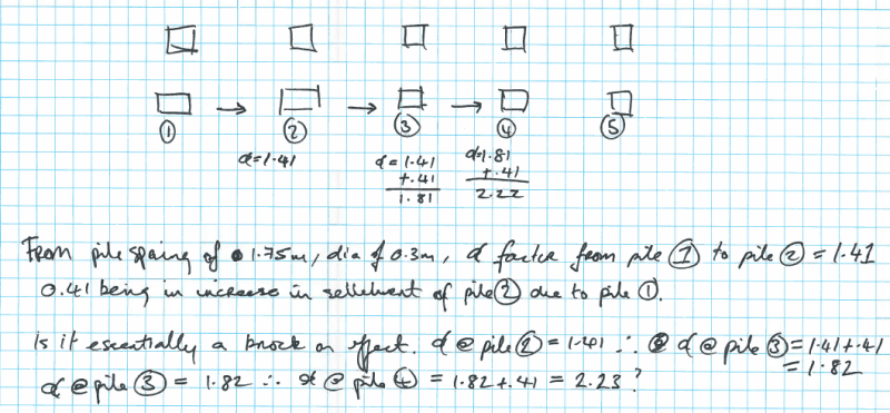

Apologies, I have been away. LRJ and SRE, thank you for your inputs and discsussion. They have been very helpful.
LRJ - please excuse me, but I am struggling to get my head around the matrix of α. I understand the idea of it, but calculating a value based on a number of adjacent piles is confusing me.
See below, I have calculated the α based on Pile 2 being affected by Pile 1. Therefore the α factor at Pile 2 is 1.41.
Pile 2 then affects Pile 3 so α at Pile 3 will be 1.41 + 0.41 = 1.82.
So on and so on, is this correct?
For a start, it's unclear how you have calculated an α of 1.41. There appears to be a missing term based on the equations you provided previously.
When calculating the influence on other piles, it's not just a case of adding the same amount over and over. The influence of pile 1 on pile 3 should be calculated using the correct spacing between those piles. Pile 3 would also be affected by pile 2 (and possibly piles in the row above) based on the loading direction depicted in your drawing.
Also, for the depicted lateral loading, it is typical to specify a spacing beyond which there are no interaction effects (this is typically 8 diameters, centre-to-centre spacing).
The matrix of α values should be 10x10 in your case (because you have 10 piles).
