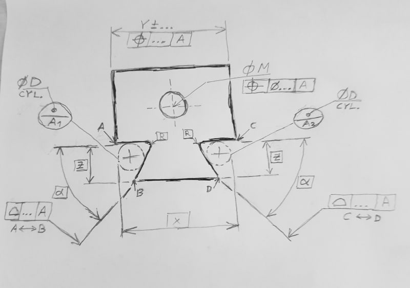

Fig. 4-49 in ASME Y-14.5-2009 displays the use of datum target spheres.
I wanted to know if it is also acceptable to use datum target cylinders. I haven't seen an example in the standard and i'm not sure whether it is allowed or not.
One case where this could be useful is parts with dovetail geometry (see picture); both for controling the dovetail taper surfaces themselves (profile of a surface referencing datum target cylinders with basic dimension distances) and for constraining degrees of freedom and establishing the DRF for the entire part.

As promised. Sorry it's handmade. All opinions and comments will be highly appreciated.
Edit: correction to the sketch - D diameters should be basic.

The cylinders on your drawing don't look like datum targets to me.
Also, if they ARE datum targets, what are datum / datum feature(s) in your set-up?
What is the DRF for your hand drawn sketch? Asked another way, the basic dimensions that you will need for the true position of the hole will lead back to what?

I too am learning English. Pardon the conffusion. They points at the centers of the spheres are the datums as evdneces by the place the dimsions start.
Although technically acccepable, I prefer to NOT have the angled surfaces located from Datum A, which is established from the same angled surfaces - reminds me of which came first the chicken or the egg. Have you considered turning the dimesionson schema "around" and locate the dovetailed surfaces from other part featreus - like the widht Y nad the hole.
This fails the same as his previous use of RFS to determine a centerplane. Same concept that only works if the parts are perfect. Otherwise, if the axes of the cylinders are skew there is no defined single solution. Since the cylinders are given a basic separation there is no guarantee they will even touch the part; all references to A can be deleted with no change in interpretation any of it. The features will be subject to a simultaneous requirement with a null datum reference.

For now i live in peace with the chicken and the egg dilemma, i'm more concerened about the question if this is acceptable according to ASME or not, because of the unusual use of cylindrical datum targets. As CheckerHater noted, they don't look quite like datum targets (and could be taken for datum target line simulators being displayed on a part drawing when they shouldn't). In any case, even if it is acceptable, i'm not in a hurry to adopt this as a dimensioning scheme.

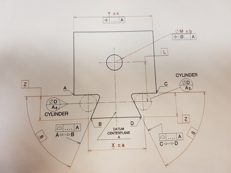

The datums that should be established from the cylinders is a center plane in the middle of the distance between them, and a plane that passes through their axes perpendicular to the center plane.
Below are some modifications i made following your and the others' comments.
3DDave, i took notice of your comment regarding the fixed distance between cylinders, the current sketch adresses this too.

Is there a specific reason why you decided to reference datum A in both profile callouts?
What if you used profiles with no datum references with addition of SIM REQT notations below both feature control frames. Then, I believe, you would not need X +/-a dimension between cylinder centers - the distance would be adjustable based on movable datum target symbol and the way how A is referenced (that is, RMB) in the other position callouts.

You are right, the two profiles should act like a pattern but they shouldn't be located (only oriented) with reference to A each other. I should have removed A from the profile FCF's and add 2X before the profile callout which would be shown on one side only, or use the SIM REQT note as you suggested.
What is your opinion on the legality of the cylindrical datum targets?
semiond,
I do not see anything incorrect in the application of cylinders to simulate datum.
In your scenario, usage of movable datum target symbol (although technically not needed as A is referenced RMB in the position callouts) will definitely help.
I am just not sure I like the directly toleranced dimension X over the cylinders...
The dimension is needed to control the size of the dovetail.
Would it be better if it was applied tangent to the cylinders instead of the centers?
