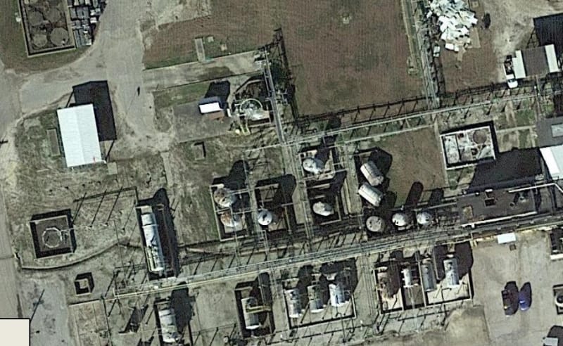

If you review the pictures in the report, one can see that this is a very small obsolete facility with rusted old facilities that should have been updated long ago for the flood risk.

Review the pictures in the report, one can see that this is a very small obsolete facility with rusted old facilities that should have been updated long ago for the flood risk. Equipment does not last forever. Is it reasonable to expect those old standby generators to work in an emergency?
'Review the pictures in the report, one can see that this is a very small obsolete facility with rusted old facilities that should have been updated long ago for the flood risk. Equipment does not last forever. Is it reasonable to expect those old standby generators to work in an emergency?'
Yeah, we have a very small, I wouldn't consider obsolete, facility with a 100+ year old brick main building, which I guess would be rusty if it were steel. And we have an old generator that we DO expect to work in case of an emergency. Let's just throw profit motive out the window, build a new facility and operate at a loss from now on.

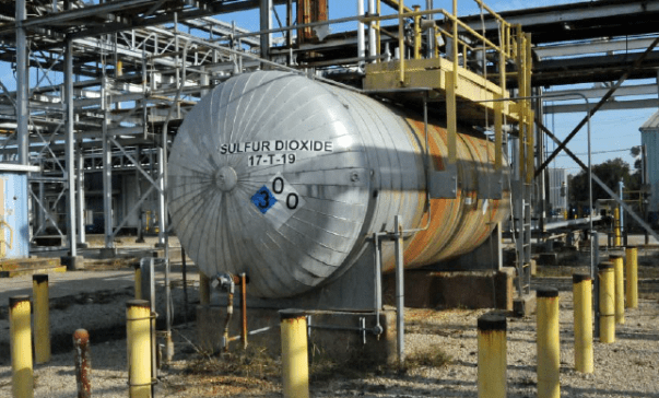

A tank containing isobutylene was located about 40 yards from six trailers that had been relocated during the storm, according to interviews and satellite images of the burning peroxides. During the flood, first responders were concerned about a chain reaction that could have led to catastrophic results. If the isobutylene tank also caught fire, a chain reaction could have caused another tank containing sulfur dioxide to explode. The sulfur dioxide presents an airborne danger to more than 1 million people if released in a worst-case scenario, according to a Arkema risk management plan filed with the federal government.
According to the 2014 RMP, the tank stores 66,260 pounds of anhydrous sulfur dioxide. Under a hypothetical worst-case scenario outlined in the report, the gas, if released, could prove harmful for a radius of 23 miles, covering more than 1 million residents.

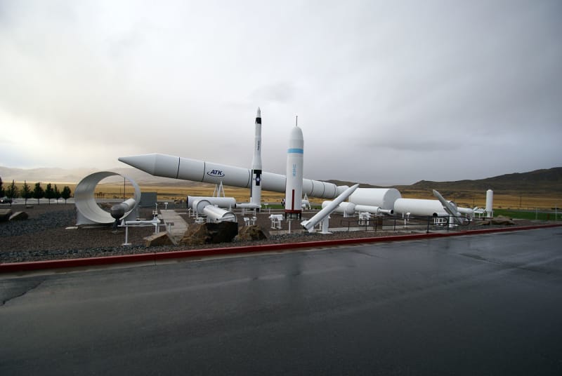

BTW, if you're ever out in Utah and are heading up to Promontory Point (where the 'Golden Spike' was driven completing the first transcontinental railroad), I would recommend that you take a side-trip, following the 'Brown signs' to the 'Rocket Park'. Located on the edge of the parking lot for Orbital ATK's Flight Systems test facility, they have on public display a very large number of rockets, everything from their first solid rocket engines, to the main section of a Minuteman missile to the space shuttle boosters. It's a great way for a couple engineers (as me and an old college buddy did in 2009) to kill an hour or so waiting for the Promontory Point National Monument to open.
