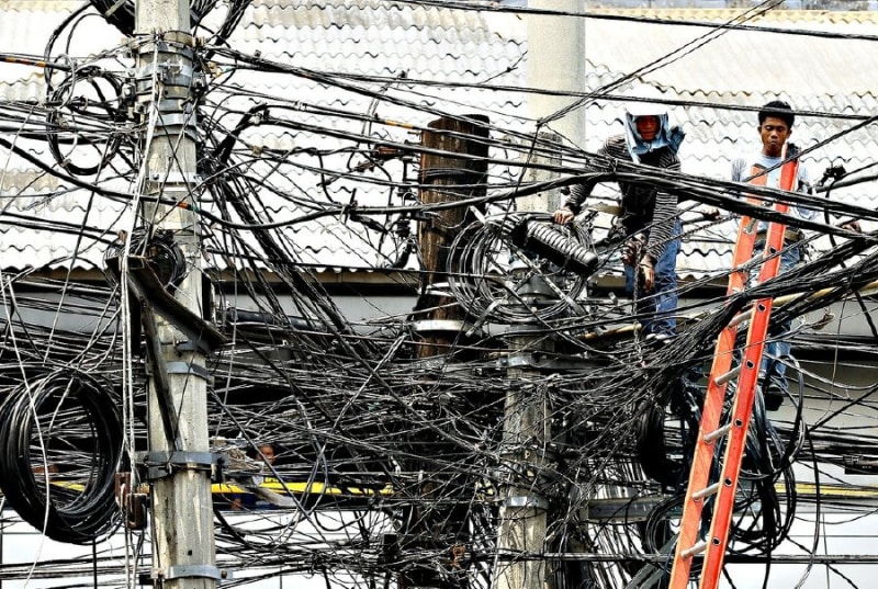

Or are you talking some sort of power anarchy:
Keith Cress
kcress -
I'm glad they knew the safe location for the ladder!
