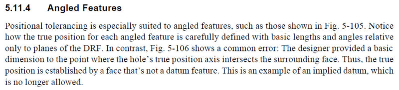

In the latest post from SeasonLee with the "Before" and "After" sketches shown, may I ask you why the "After" method is the preferred one?
Does anyone can offer the relevant verbiage from the book? What would be the justification in the textbook?
I am trying to learn something here.
@greenimi
Its a snapshot from Paul J. Drake "Dimensioning and Tolerancing Handbook" page 5-117/118.
Season
SeasonLee,
Your "after" drawing is very much more inspectable, but can you bend the sheet metal accurately enough for the Ø0.010" positional tolerance? One of the benefits of good drafting is that it highlights bad design.
