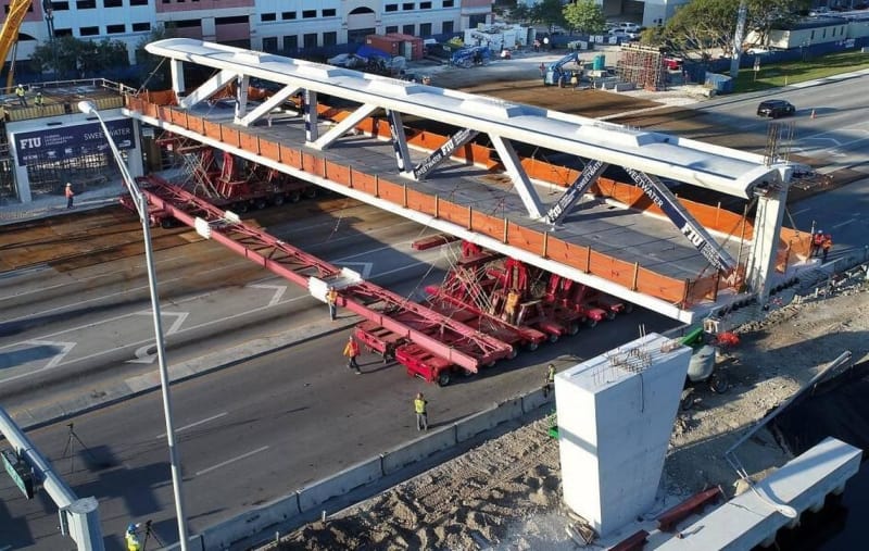

Correct me if I'm wrong, but after reviewing photos and videos here, it appears that both faces of member 11 are completely wrapped in that banner, "City of Sweetwater, FIU, Florida International University." This banner would obscure any shear cracks that would've developed in member 11 warning of a potential failure.

"Correct me if I'm wrong, but after reviewing photos and videos here, it appears that both faces of member 11 are completely wrapped in that banner, "City of Sweetwater, FIU, Florida International University." This banner would obscure any shear cracks that would've developed in member 11 warning of a potential failure."
I'll go one better....
During transport, there was a stoppage for an extended period of time, while 3-4 workers inspected the south end @ #1/#2. They did this 2x, that is to say...on deck, down, & back up again. There was no evidence of inspection on the north end. Interestingly enough, one of the drone videos shows a rapidly flashing light on north end #11 bottom/fillet during this time. After wondering about all this for a while, I have to wonder if they got sensor wires crossed fromm north to south. It would explain a lot, because the south end was very robust by comparison to north, & likely didn't have any issues.

Reply to TheGreenLama about banners
Banners being installed March 9, 2018 Video 1 Link
Video 2 (Please excuse worker for temporarily not wearing hardhat.) Link
Some type of sensor may be attached to member 11 under banner. March 9 photo of member 2 below. (Not a camera, cameras are on sticks in corner of orange mesh)

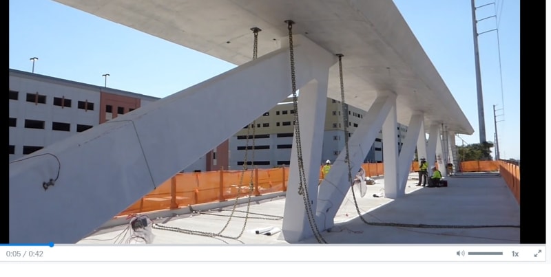

Perhaps chains attached to span were meant to address "seismic" stress during move. How tight were those chains tensioned? Could they have caused cracks at the 90 degree intersection between member and deck?

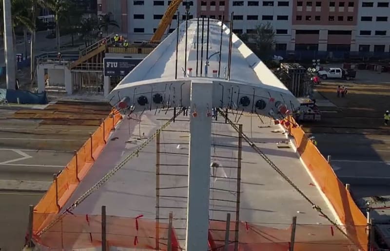

A question that has been in my mind, about the grouting of #2 and #11. It might be possible to see from the sequence of photos whether the work being done on the day of the failure was a late modification instead of the planned de-stressing.
The construction specifications say that the PT bars in #2 and #11 "will not be grouted", and it's clear in the videos of the span being moved that #2 and #11 were left ungrouted (while other blisters have been filled in). On the day of the bridge failure both #2 and #11 are obviously open. But some photos seem to suggest that in the intervening time, #2 and #11 were grouted, as though the planned work was already complete, and only later chiseled out again. (Also there is a chisel clearly visible in post-failure photos, as many commenters pointed out). The photos below were posted by LittleInch on the V thread at 29 Mar 18 09:13. They seem to show the span set in place and with all blisters grouted, including 2 and 11. Can others judge whether this is just an optical illusion? It seems important to figure out which.
The best photo I found is this (full res attached). It appears 2 and 11 blisters are open - which would be necessary to tighten the rods before transport (other blisters appear sealed).
This has audio interview with investigative reporter Tony Pipitone at beginning. It specifies if "post-tensioning" is 'loosening' or 'tightening' (this has been confusing all along). He says the span was set in place and "tension was released on those outer diagonal trusses" soon after (~3:30), then about cracks and "adding tension" to the rods. At ~4:30 he says this was NOT a stress test, but actual work to address something that had been discussed at the meeting that morning.
This is a good video by him saying the south end was adjusted then the north 3/4 done when it failed. There's a "puff" mentioned but think consensus here is that's the northwest corner of the deck, but after that a dark triangle below it appears which consensus seems is #12 kicking out (you can see this better in Part V - video loop gwideman 28 Mar 18 07:00, and frame grabs TheGreenLama 28 Mar 18 16:55)
This article specifically says the south side was adjusted (both rods), one rod of north side adjusted, and then failure when remaining north rod adjusted (upper with jack)
