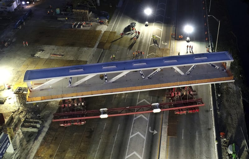

It's being reported that the structural span portion of the bridge was just erected this past Sunday and that there were workers on the bridge when it collapsed.

Looks like it used the roof structure as the top chord of the truss. I wonder if the webs broke free from the bottom chord?
RE: Miami Pedestrian Bridge, Part I
I wonder if the bottom section failed in tension then the top section buckled. The length to depth ratio looks very high. Were the cable reinforcement properly tensioned and were there provision for connecting and tensioning the reinforcing cables between section assemblies to unitize the assembly?
This article shows a rendering of the completed, cable-supported bridge.
This may a case where the team thought that the existing deck structure was strong enough to self-span the roadway while the cables and tower were erected. I wonder if the warm Florida sun hit it, made it expand, and the temporary construction load + expansion broke loose a metal-diagonal-to-concrete-web-chord connection...

The bottom section looks continuous. It would be in tension, so a failure would leave a gap. The top chord is in compression and can't separate and looks continuous. This leaves the shear members and I expect this is a failure of one of the connections, either via shear or by punching though one of the decks. It's also possible the upper chord buckled.
The horrific part is that the bridge fell on a large number of cars that must have been stopped for a traffic light. It seems that at least 4 and possibly as many as 10 vehicles were under the bridge.
One witness reports that a support failed sideways, but I think that must have been in reaction to a failure elsewhere.
The lack of symmetry and the irregular columns is unsettling. See http://www.miamiherald.com/news/local/community/mi... Obviously without knowing the reinforcement making a call about sufficiency is impossible, but I am unnerved by the second column on the campus side; the side that fell on the cars.
Edit:
I see that this was to be cable supported. That explains the irregular beams and columns. Someone didn't do a good job of analyzing the partial construction strength.

Looks like it is a temporary construction condition. Cannot see any sign of the second span or the cable stays etc.
You do have to wonder about the scheme. If the truss was supposed to be able to span simply across the roadway without the cable supports, why were the cable supports necessary at all? In the completed structure, it looks like the truss was to be continuous, and cable stayed. So the temporary condition was critical. I know, more loading in the permanent condition, but not enough to override the construction loading.

hokie66 - I have looked at several pictures and it does appear to be a concrete truss with post-tensioned bottom slab/chord. The truss web arrangement would appear strange, but looking at the final design, the webs match the angles of the permanent cable supports. Still they're not symmetrical at all for this temporary construction condition. It's a long span with certainly a lot of dead load and high truss web member forces. It's not a typical truss web arrangement, and it's a concrete truss. That's a lot of unconventional items in one large design.

All the end reaction went up that first diagonal in compression, and the next diagonal couldn't take it. Maybe a failure of the anchorage of that diagonal, or maybe incidental moment in the connection. A concrete truss was a poor choice. Many of these have been done in steel, which provides the ductility necessary to cope with things a bit out of alignment. I know that Figg has done many bridges, some a bit heroic, but I think they would be wishing they had not done this one.

3
At the time of collapse it appears they were stressing PT bar/s to the first COMPRESSION diagonal from the top flange, at the first interior 'node' from the future stay-cable tower, as per the following photos:
Future stay-cable tower to the left of the photo:
Photo looking along the longitudinal-axis of the bridge:
General view during erection:
After they set the bridge in place, they de-stressed the two top deck tendons. Link
The column at the end of the bridge where the tower was to be built, was only half of its final width. Once the other half of the bridge was in place the two half columns were to be joined together & the column would have had an octagonal shape.
Here is an interesting angle Link

Are we sure it was the first diagonal in compression that failed? What about the second diagonal which is running the opposite way and is in tension? How do you handle the connection at the bottom between the tension member and the bottom chord of the post tensioned slab? Is there a tendon or two that run thru a sleeve and then anchor into tendons running thru the diagonal?
It looks from the video like the bottom slab/chord buckled in flexure between the first and second diagonal.

I would assume that the bridge under construction and transportation had intermediate supports and a corresponding pretension of the strands....when this section of the bridge was in place and the intermediate supports were removed then it experienced for the first time the forces and deflections caused by spanning the full length of the first span resulting in more compression in the top chord and thus a lessening in the tension present in the strands and thus the attempt to re-tension them...for a simple single span the top chord would always be in compression so why is the added tensioning required at this stage in construction...could it be possible that the temporary compression in the top chord due to the single span during construction plus the added design tension in the strands based on the completed bridge have contributed to the collapse...again, this is all speculation on my part, at the moment....

I think the tendons being de-tensioned are TEMPORARY PT bars in the top of the top flange- the wheeled trailer support was centered about the first interior node point, so maybe that 'overhang' necessitated the temporary PT.
And this would explain the stressing operations occuring in the collapse photo - the photo above I posted may be the crew de-stressing the top bars (NOT the compression diagonal, as I first stated) - there is a large stressing stool in front of the ram - that is often used to access the nuts from threaded PT bar and therefore enable destressing.

I saw a traffic cam video of the collapse. They were tensioning tendons in the first diagonal when there was a sudden collapse, apparently buckling the top chord plate. Under a simple span condition, that would be a compression strut. Under the cable stayed condition, there might be load reversal (depending on the support scheme)....thus a need for tensioning. Any possibility they tensioned this member out of sequence? Tensioning of this member should probably have waited for the cable stays.
We're all guessing at the reasons....could be all or none, but certainly interesting though incredibly tragic. Unfortunate for all involved and their families for their loss. This will gone on for years to come.

Were those red shoring towers removed when collapse occured?
tomfh,
Yes, it was spanning full length.
Quote (Tomfh)
Tomfh (Structural)
17 Mar 18 01:14
Yes, the portable red lifting rigs were only used to move the bridge segment from its (nearby) fabrication site to the installation point. They were NOT under the bridge when it collapsed - which had a full traffic flow: 3x lanes each way.

Break down of video:
Frame Prior to Collapse:
Not sure if it is the video or if the first diagonal is buckled and maybe the section of top chord between the first diagonal and end of the bridge:
First diagonal appears buckled and the bottom chord has collapsed:
Following Frames:

RFreund - Saw that yesterday evening as well but later when I looked at it, the video may have played differently. I'm wondering if the work on the canopy was to De-Tension Truss No. 11 on the north end. They may have been there for more than one purpose.
The original proposal had both sets of the Self-Propelled Modular Transporters spaced apart. Starting on the south end (FIU) the first rig was planned to be positioned directly under the south end of the span & the next rig 24 ft to the north. At the opposite end, north (Sweetwater)/Pylon, one rig was again to be positioned directly under the north end of the bridge with the final rig 27 ft to it's south. As it turned out this plan was too wide for the road way and they may have encountered a hiccup with uniformly supporting the bridge when driven over the center divider. It looks like they still had trouble driving over the center divider, even with the tandem Self-Propelled Modular Transporter arrangement. They stopped half way across and just sat their for a long time. Since the Self-Propelled Modular Transporter was no longer under the ends of the bridge, I wonder if they decided to PT the No. 11 Truss, with the intent to De-Stress the truss once the bridge was in place. It sure seems like it took a lot longer than 6 hours to position the bridge. It looked close to midday when they we finished. Link
3
By way of summary of the PT that made up this bridge:
1. Transverse bottom-flange PT: 4x0.6" dia, 7-wire strands, GROUTED tendons @ 2'6" spacing. These tendons were fully stressed, capped and grouted BEFORE transportation.
2. Longitudinal bottom-flange PT: 10 groups of 19x0.6" dia, 7-wire strands, GROUTED tendons typically, except T6 were 12 strand tendons. These tendons were fully stressed, capped and grouted BEFORE transportation.
3. Longitudinal top-flange (canopy) PT: 4 groups of 12x0.6" dia, 7-wire strands, GROUTED tendons typically, except C3 were 7 strand tendons, GROUTED. These tendons were fully stressed, capped and grouted BEFORE transportation.
4. Truss diagonal member axial PT: 1-3/4" PT bar (probably Grade 150 ksi), probably full-threaded. I would expect that the majority of these PT bars would have been stressed, capped and grouted BEFORE transportation EXCEPT for the temporary PT in the end diagonals.
The so-called media reports of "loose cables" having to be re-tensioned is highly suspect. All the photos that I have reviewed of the collapsed bridge show black-colored grouted end-caps (at the ends of the bottom and top flanges), and none that I have found to show any with 'stressing tails' exiting the ends, EXCEPT for the PT bar being de-stressed to diagonal member #11.
Over on The YouTube channel AvE, the host made an interesting point in his latest video (https://www.youtube.com/watch?v=KtiTm2dKLgU) - the tensioner was far out of the hole. His suggestion was that stored energy from tensioning popped it loose when the tensioning rod failed. If it was still pulling and the rod intact, it should be up against the concrete cap post-collapse.
This makes some sense as to the buckling of the concrete strut - the rods in the preliminary plans are off-center. If one fails and the other is still under tension there is a moment introduced into the member.
Maybe they were trying to pull hard enough to close a crack and popped one of the rods instead, leading to buckling of the member.
Per the original plan - there was no PT to be applied to #11. Not only is the tension "-", there is no member type (A, B, or C) specified to tell where the tensioners are to be placed in the member.
In this picture
it looks like a trench was cut on the anchor blister over member 10-11. This trench is not obvious in the post-collapse images. There is a similar trench into the anchor blister over member 2-3. Both align within the body of the most steeply sloped member. This is the same image as
the post epoxybot (Structural) 17 Mar 18 04:22 linked to; it's easier to zoom in on epoxybot's linked image.

I know we are all very curious to know what exactly happened, so here is my 2 cents.
I have very little experience with concrete, and none with pre/post tensioned concrete structures, but it appears to me from the dashcam video and the method of collapse that the first compression member's connection (where the alleged de-tensioning or tensioning operation was occuring) to the upper chord failed in shear.
If AVE's assertion is correct that the PT rod and ram being ejected some distance out of the conduit is evidence that the construction crew tensioned beyond the Fu of the rod, why would this cause a collapse of the entire structure? (being as it is a compression member and all)
What levels of redundancy are typical for a structure of this type?

Quote (EPCISteel)
but it appears to me from the video and the method of collapse that the first compression member's connection (where the alleged de-tensioning or tensioning operation was occuring) to the upper chord failed in shear.
I had the same thought. Maybe the rods clamping stress was in fact keeping the member and joint confined, keeping the member and node intact.

Tomfh (Structural)17 Mar 18 21:25
It appears to be a single rod hanging out the ends. That would make sense if it was just there to carry the weight of the overhangs during lifting.
Detail shows one pulled from the top and one pulled from the bottom....but it could have only been one in #11
Video from foreman with MOM stated that there were 2 tendons to detension (after bridge is set on abutment) and they can reopen traffic
I wonder if these 2 tendons were detensioned....traffic was reopened...cracking was observed so FIGG decided to retension the strands due to cracking...then when pulling the top one....it either snapped or the node busted
Quote (structuralengr89)
That would make sense.

The video would suggest that we are focusing on the wrong member, 11. The collapse occurred at the top and bottom of member 10. And if others are correct, member 9 which intersected with 10 at the bottom, had no prestress. But wherever the failure actually occurred, the issue here is joints in a concrete truss/frame. In these forums, we often discuss problems to do with efficiency of concrete joints, and it is widely known that they can't be 100% efficient, but I don't know of any literature about design of concrete trusses per se.

Here's a couple of frames from the vid. First frame is immediately before collapse. You can see #11 intersects with the node.
Following from that, something has happened to #11, and it no longer aligns with the node. Pity that crane is in the way.
Here's the relevant frames from the CCTV. Not a great video, however it appears something's happened to #11.
There are 6 canopy tendons altogether, but they appear to have two of them tensioned only for the movement portion and then relieve tension after placement. In pictures, 4 of the six are capped, leaving access to the remaining two. I believe those are what the guy in the video was talking about when he talked about removing tension.
The work on member #11 happens after cracking is reported.
I think the construction crew was working with faulty information and tried a fix for a condition they didn't understand.

The design of this pedestrian bridge was apparently driven by the appearance, not the structural efficiency and safety. The truss could serve without stays, but single diagonals and posts were not sufficient for the wind loads and required redundancy.
As usual, the devil is in the details - lack of mild reinforcement at the joints, where the stresses are almost unpredictable, post-tensioning of the compression member lead to this disaster.
Eugene Figg was a great engineer - but apparently the "successors" do not have the same capabilities. And even greatest legacy do not do the design - it's just the designer in charge of the project.
So, the recipe for for disaster is rather simple - great legacy company, inept design, and no response to apparent overstress signs.

Excellent and sobering discussion. It seems pretty likely that de-stressing member 11 caused the collapse. If the temporary PT was stressed to 200 kips, de-stressing it would have significantly increased the tension in the adjacent members. Listening to the voicemail was really chilling. I am certain that I have spoken almost the same words more than once in response to s**t happening during construction. Very often, the cracks we see really aren't safety issues. Engineers are human and can make mistakes. What kind of systematic rules could prevent this from happening again? Definitely no adjusting PT in non-redundant structures with traffic below. But in general how do we make sure the right decisions are made, especially during design/build projects?

This photo indicates that the deck slab which was acting as the tension chord of the truss, pulled away from the column and pier. The end diagonal, column and canopy slab still seem to form a triangle after collapse, although the connection between the end diagonal and column cannot be seen.

Reading through the above and (most of) the links, I can't see anything to say where the pre-failure cracks were found - apart from the "at the North end" in that voicemail message.
Have I missed something along the way, or do we not actually know that yet?
I wonder if the cracks might eventually turn out to have played no part in the ultimate failure. Too early to tell.

BA, I had noticed the same thing... that the top chord, end vertical and first compression diagonal seem to still form a triangle after the collapse, but, as you point out, it's not clear what the condition or status of the joints is, or whether they are even still really connected or simply "leaning" on each other.
Also, in the screen shot that BA posted a couple of comments up thread, it looks like, in general, the PT anchor "blisters" on top of the canopy/top chord have mainly stayed in tact but fractured or sheared off the from the main canopy/top chord. That seems odd to me, unless they had been cast separately, had a higher f'c, had some mild steel reinforcing in them, or something along those lines. Anyone else think it is odd that the anchor "blisters" would stay in tact but separate from the top chord?
gte447f, true but there can be no doubt that the tension chord became disconnected at the end; and without the tension chord, the truss must fail.

BA, yes, definitely can't have a truss without a tension chord. Look at the zoomed in video posted by Tomfh up thread a little bit. It is very fuzzy, but in the second frame, it looks like you can make out something shooting up vertically from the top chord first panel point and in the same frame there appears to be an "explosion" of dust at opposite end of diagonal #11 at the bottom chord bearing end bearing. What we see in this frame could be the result of the PT rod rupturing under tension and erupting out both the top and bottom ends of diagonal #11. The object that appears to shoot up in the air from the top chord would be the stressing ram still attached to the live end of the PT rod. The dust cloud at the bottom of the diagonal would be the dead end anchor plate erupting out of the concrete. What do you think?
gte447f, sounds plausible. Perhaps the stressing ram is the mysterious "blue box" reported in the Wikipedia article.

From this reddit post someone spotted two tendons in the PT Blister and if the mysterious "Blue Box" was the the control box in the same picture and it dropped, well..., that would have been very bad. Link
I'm skeptical of the "reports" of a blue box being dropped from the crane onto the canopy/top chord just prior to the collapse. Some of the same reports mention the blue box hanging from a blue cable. Who has ever seen a blue cable? Some of the same reports that mention the blue box falling from a blue cable quote congressmen as saying things like, and I am paraphrasing here, "they were conducting a stress test... they were impacting the bridge with a load to see what it could handle", implying they were intentionally dropping a load onto the deck to see if it could handle the impact. Of course that is absurd. Even Marco Rubio has made statements about the "cables that suspend the Miami bridge", when of course we know there are no suspension cables involved. So, there is a lot of uninformed information out there.
Now there was a crane there, and you do wonder why. What was its roll during the tensioning/detensioning operation that was going on? Could something have fallen from the crane? I suppose so, but why would something fall from the crane, and what would be large enough to contribute to the bridge collapse? What are the chances of 2 catastrophic failures (the crane and the bridge) happening at the same time, or I suppose one catastrophic failure resulting an an immediate second catastrophic failure?
Of the two blue things in the photos of the collapsed bridge, one (the cylinder) is the stressing ram/jack and is still attached to the PT rod which has clearly erupted from the diagonal about 5 or 6 feet, and the other (the box) I think is the hydraulic gage to monitor the jacking force. I think this gage would have been on the deck right next to the workers stressing the pt rod, not suspended from a crane.
Thinking out loud, all of the stressing equipment (hydraulic ram/gauge/pump) is heavy to lug around, and likely would have been hoisted up top with the crane instead of manhandling it up there. You can see maybe a lifting line and a red tether in the photo above that may still be attached to some of the equipment (I can't tell). Or, could it have been fall protection for the workers?

gte447f - I have been skeptical of witness statements as well because they are often unreliable. There are actually 3 blue objects. The ram, the metering/pressure rig (control box) and the hydraulic fluid reservoir. With the arched canopy, the thought to sling the control box from the crane might have seemed like a good idea at the time. If indeed, this was the case, then the investigators probably already know that, when the control box fell and uncontrolled pressure surge to the jacking ram overloaded the tendon. Full Size Photo: Link
Original 'Powerteam' orange that was re-painted in VSL 'blue':
Full of oil, these pumps weight about 65 lb.
Stressing is always a two-person (minimum) operation: pump operator and jack 'stressor'. If you look at the videos that Tomfh and epoxybot post you can see a guy fall as his lanyard tie-off breaks, so likely that the pump and operator were in a 'dog box' suspended from the crane.

If the "pipe stays" were indeed almost cosmetic, then it bothers me a lot that all of the diagonals of the truss were aligned with the stays, instead of given simpler geometry.
Don't let some engineering get in the way of some bridge 'art'. It is in PINK for sarcasm!

Quote (It seems pretty likely that de-stressing member 11 caused the collapse. )
I agree, but the whole situation is still puzzling. Was the span designed as a truss or as an "I" section with web cutouts? If we assume it was designed as a determinant truss, Members 2 and 11 would have been in tension while the bridge was moved into place, based upon the position of the SPMT's in the photos, thereby requiring PT. Also,the deck or bottom chord of the first and last panels would have gone suddenly from compression to tension once the SPMT jacks were lowered. Perhaps in the final position, Member 11 had too much compression, which resulted in the "de-tensioning" operation.
IMHO, if it were designed as a truss it was the wrong approach. Forgive me if I'm rambling.
With regards to discussions about tensile failure of the PT bar, the stressing levels to PT bars were significant on some of the members, especially member #10.
The PT bar appears to be Williams Grade 150 ksi: Link.
For the 175' span truss, member #10 had its 4 PT bars stressed to 280 kips each. Min. UTS is 390 kips, so max was 72% of ultimate tensile. PTI (and manufacturer's) recommendations stipulate max of 80% of MUTS for test loads (usually for rock or soil anchor type projects where proof testing is undertaken), but there is also a requirement that the lock-off load should not exceed 70% of the specified minimum tensile strength. Threaded PT bar does not undergo significant seating losses like strand/wedge systems, so the stressing load is the lock-off load, for all intents-and-purposes.
The other PTI requirement is that the design load is not more than 60% of the specified minimum tensile strength of the prestressing steel.
The other PT bars to members of the 175' truss were stressed to 52% and 62% of MUTS.
I have not seen photos to show evidence of a tensile failure of the PT bar. The 10 foot 'projection' of the PT bar and jack from the canopy 'blister' could be explained by 'nodal' failure at the bottom of member #11 diagonal, where the bottom chord appears to have ripped away from the support 'node'.

What I see in the two photos are a Blue ram & control box with what looks like a blue plastic reservoir (with rounded corners) and then in the other picture a scratched blue metal ?reservoir?. Perhaps in the photo with the A & B designations the reason the third item cant be seen is because it is behind the fireman. IDK.
All the photos show me that the failure was a joint failure rather that a member failure. Both ends of Member 10 developed hinges at the same time. We have focused on PT in the members, but have no knowledge of bonded mild steel reinforcement in the structure, or of the joint reinforcement.
Just wondering...of all the engineers here, has anyone ever designed or had knowledge of a concrete truss?
Bridgebuster, you have it right, a truss made of concrete was the wrong approach.
