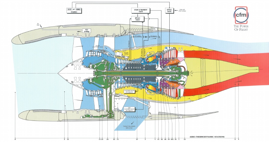

The emergency doors over the wings are further back than where the missing window is located, and the engine is actually mounted such that most of it is not under the wing but rather ahead of it. And the actual 'jet engine' only occupies about one-half the length of the engine housing and that's mostly in the rear half. The front half is where the so-called 'fan' is located and it's that part of the engine where the largest blades are found and why there is that Kevlar shield around the fuselage.
As for SW and this particular type of engine, they're not the only airline using them. In fact, my wife and I are flying home tomorrow morning, from Detroit back to SoCal, on American Airlines. And we will be flying in a Boeing 737-800, the same model as the SW jet involved in today's incident, and they are using the same engines, the CFM56-7B.

For reference purposes, here's a cross-section of a CFM56-7B engine showing how it's positioned inside the engine housing:

Jet engines have a Kevlar containment shroud inside the nacelle (cowling). In the photo the nacelle is now missing and the yellow containment shroud is visible. Propeller planes have the protection only on the fuselage for protection against detached blades. I have seen the specialized loom that is used to weave the fabric that is used for the shroud. The fabric is wound onto a spool that has the same barrel shape as the completed shroud. Test video here:
When a fan blade separates it is under both radial load from rotation and axial load from thrust production. It was theorized that there is a combination of the two that sends the blade forward from the fan-disk and out through the inlet. Others think that other blades just bash the loose one out the front. There is often extra damage to the fan and not enough fragments of the inlet to be certain about those few milliseconds. The blades aren't especially dense for the projected area they have and I expect they can deflect as they tear through the cowling. The last time a blade exited it left a considerable dent about mid-chord, just below a window, leading to a smaller leak. I think it was the blade as nothing in the inlet seems substantial enough to do the damage and that it just happened to shatter the window in an unfortunate trajectory.
