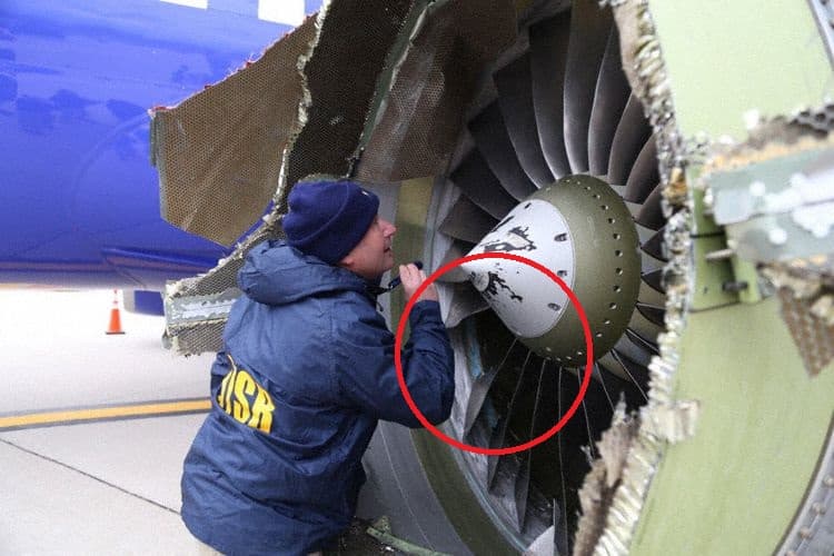

Southwest Airlines flight experiences engine explosion but makes a safe landing in Philadelphia... 5
A photo of NTSB examining the engine apparently shows a gap in the fan blades.

From Canadian Press, "Last year, engine maker CFM International and FAA instructed airlines to make ultrasonic inspections of fan blades of engines like those on the Southwest jet.
PHILADELPHIA — A preliminary examination of the blown jet engine of the Southwest Airlines plane that set off a terrifying chain of events and left a businesswoman hanging half outside a shattered window showed evidence of “metal fatigue,” according to the National Transportation Safety Board."

Inspection records will be closely scrutinized for SW airlines. I hope an inspection was not missed or done poorly.
I believe the engine on the SW flight did not have the number of cycles that the bulletin set. If I'm remembering right the bulletin was for 15,000 cycles and the SW flight engines were at 10,000. It looks like the FAA is recommending all CFM engines in 737s get a closer inspection of the fan blades. Apparently CFM engines are used in Airbus aircraft as well; I wonder if the reason this has hit 737s twice is the asymmetry of the inlet providing slightly more cyclic loading on the blades.
