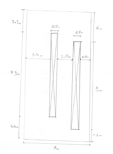

Hi all.
My questions are regarding contraction joints in structural topping. I am completely new to this topic. Contraction was to lay bonded structural topping (the thickness between 25 up to 50 mm on an in-situ slab) and forgot to apply contraction joints. The topping cracked and they have to lay a new one. The slab has openings as shown on the drawings.
1. They intend to apply contraction joints every 3 m. ,every joint running along the shorter side of the room . The contraction joints will not be aligned with the openings edges. Can it be like that? Are the joints not supposed to match the edges of the openings?
2. They intend to put a mesh ,just in case. I always thought that in bonded system a mesh is not used. If it is ok to use mesh what maximum thickness would be allowed so there is not too much steel in the concrete.
3. Aren’t joints between the topping and the walls supposed to be also applied?

it is on first floor spanning between beams
With those two long openings in your suspended slab, it is a bit difficult to know how the slab is supposed to work. How thick is the slab? How it is reinforced?
Do you need the topping for strength or just for leveling? If for strength, then shrinkage control joints make the situation worse. You would be adding mass without adding strength.
This thread is missing the reason for the work. What doesn't the building have now that it will have after the topping is placed? (Drainage, flat enough to lay tiles, increased strength etc).
I'm going to guess the structural system is beams parallel to the openings and a one-way slab spanning in the short direction. The 3m joint spacing makes a bit of sense for that. This information is also needed to answer the question properly.
Sorry for the lack of information
The screed is purely for levelling purposes and beams run along the shortest side of the building (across) (obviously there are beams around the openings as well). The building is an electrical substation. Although the screed is for levelling purposes it will have to withstand quite heavy equipment (transformer) before finally placed onto the openings.
