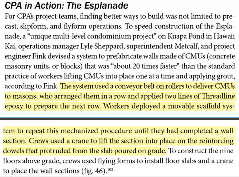

Semi-automated CMU wall construction ==> Pankow circa early 1970's
Ingenuity
May 17, 2001
2,374
I am currently reading this book: Link: "Better Way to Build: A History of the Pankow Companies"
Some very interesting pioneering methods were developed/tweaked by Pankow for building construction in the late 60's through early 80's, and beyond (slip forms, jump forms, flying forms, PT slabs, 3-day floor cycles, precast hybrids, etc).
Has anyone seen CMU walls constructed in the method described below, other than the stated project:
1) Never heard of CMU built that way.
2) Thoroughly impressed with your commitment to structural/recreational reading. Keep sharing the titles for those of us not energetic enough to seek out our own.
3) Empire state building shipped masonry around the floor plates on little railroad networks. That's considerably lower tech however.

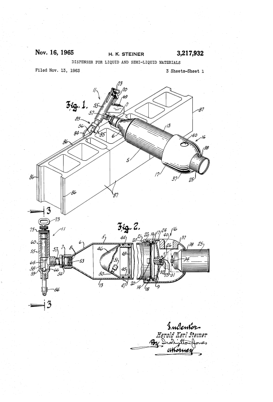

With regards CMU manufactured walls, found this patent for dispensing epoxy mortar for blocks:
Link: US Patent # 3217932
