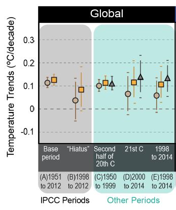

4) The “Pause” is not Statistically Significant.
As has been made evident from the previous 3 points, the “pause” was always an incredibly flimsy argument that required carefully selecting a short-term period and completely ignoring any other context. Upon investigating it in proper context, it immediately falls apart. So, a very natural question is, “was the “pause” ever statistically significant?” The clear answer is no.
This point was demonstrated by two recent papers. The first is Cahill et al 2015. They highlight the whole situation surrounding the “pause” quite well by stating:
Cahill et al 2015 said:
While close to 50 papers have already been published on the 'hiatus' or 'pause' (Lewandowsky et al, in press), the important question of whether there has been a detectable change in the warming trend (rather than just variability in short-term trends due to stochastic temperature variations) has received little attention.
Co-author Stefan Rahmstorf wrote a blog post discussing the concept in detail. The Cahill et al paper used change point analysis to search for discontinuities in temperature trends that would give credence to the term “pause”. They found nothing to support it.
[image ]
…no evidence of any detectable change in the global warming trend since ~1970. We conclude that the term ‘hiatus’ or ‘pause’ cannot be statistically justified.
The second is Foster and Abraham 2015. Like the first paper, co-author Grant Foster wrote a blog post detailing the topic. They focused on 1970-present data and tried various test specifically designed to find such a trend change. They concluded:
Foster and Abraham 2015 said:
A barrage of statistical tests was applied to global surface temperature time series to search for evidence of any significant departure from a linear increase at constant rate since 1970. In every case, the analysis not only failed to establish a trend change with statistical significance, it failed by a wide margin.
