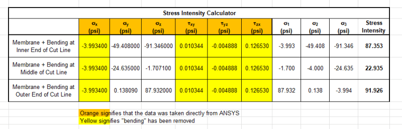

Are you saying to manually calculate stress intensity (or von Mises) in a software like Excel, at each point along the cut line, by taking the individual components from ANSYS?
The approach is NOT to calculate the equivalent stress "at each point". The approach is to take the membrane (and bending) stresses of each component. Then, using the membrane and the membrane-plus-bending of the appropriate components to form the equivalent stress. It is one calculation, based on the membrane (and the two components of bending) to calculate the equivalent membrane-plus-bending stress.
Yes thank you. I understood that to be the case. However, I don't think I worded my statements the best...I need linearized stress intensity to do Sec. III code qualifications. My understanding is that I have to linearize the 6 components in ANSYS. Then, using the membrane and membrane-plus-bending of the appropriate linearized components, I need to calculate the equivalent stress intensity in Excel for each location along the stress cut line. Is that correct or am I misunderstanding something? I have shown an Excel example below for membrane-plus-bending at three points along a cut line.
That looks good to me. Nicely done!
