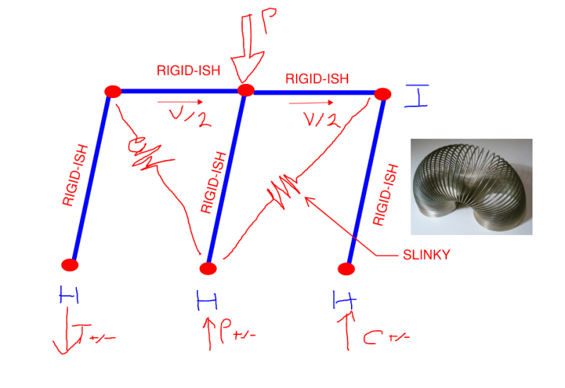

I want to disagree with the Breyer's textbook about including distributed dead loads in the compression force in a chord for a shear wall. Points loads that the chord normally supports vertically yes, but not distributed loads across the entire wall. Here is why:
1. The SDPWS starts by using the same equation for the compression and tension in the chords. For the tension, the code specifically implies in 4.3.6.4.2 that the dead load may be used as a stabilizing moment to reduce the effect of tension. However, the code does not imply anywhere that an increase in the chord forces from that same dead load is required. I assume then, that theory of adding the load to the compression force came from the idea of "well, it was subtracted from the uplift."
2. It makes sense to me that a distributed load would help prevent an entire wall from lifting up on one end. I don't picture the distributed load assisting as if the wall is spanning chord to chord, but that the dead load over each portion of wall provides some resistance to it's own sphere, which ultimately prevents the whole wall from lifting (assume the dead load is enough to prevent uplift). However, to say that these vertical forces are amplifying the chord forces would imply that the wall has to span chord to chord - but the wall is much too flimsy to do that. The vertical distributed dead load remains supported by the distributed series of studs and headers, so it feels unnecessary that the chords would suddenly experience that force as if the studs weren't present.
Anyone want to provide additional insight?

driftLimiter said:
Does anyone know of any test data that measure the actual hold down force on a wood shear wall with gravity loads?
This will be lame but here it goes. Several years ago now, it is my recollection that we discussed this same issue and somebody ponied up with a research paper in which the researchers considered a squat shear wall with a point load applied to the middle of it with the intent of discerning to what degree the chords "felt" that point load. And it is my recollection that the chords did not, in fact, feel the point load appreciably.

DaveAtkins said:
It's static equilibrium.
Unfortunately, it's not just static equilibrium. Like most things, stiffness plays an important role.
Here's how I believe this works from a theoretical perspective, with reference to the diagram below:
1) The load response -- in the sense of the work that the external shear load performs -- gets divided up into a Bernoulli flexural contribution and a shear racking contribution. Both modes contribute to chord forces with the sum being unaltered by the amount of work done by each mechanism. The sum is a function of equilibrium. The distribution, however, is not.
2) For most things, the Bernoulli flexural load path dominates the stiffness of the system. In such cases, it is reasonable to ignore the shear racking mode entirely.
3) For a squat, multi-panel shear wall, the situation is different and shear racking plays a role that varies between significant and dominant.
4) The chords of the Bernoulli flexural mode will "feel" an intermediate load. The chords of the shear racking mechanism will not "feel" and intermediate load. Consequently, the more load response that is attributed to the the shear racking mechanism:
a) the less an intermediate load will increase compression chord forces.
b) the less an intermediate load will decrease tension chord forces.
c) the less an intermediate load will decrease chord hold down forces.
Basically, the more dominant shear racking deformation becomes, the less intermediate wall loads affect the chords.
I've long noodled over a discretely braced analog that would:
1) Produce a similar, theoretical effect as I discussed in my last post and;
2) Speak to one's intuition more directly.
For now, the model shown below is the best that I can do. I feel that we could all agree that:
a) The "chords" of this thing will not feel "P" appreciably and;
b) The "chords" would still feel "T" & "C" in the conventionally envisioned manner.
This, again, because this is a deliberately "shear flexible" system by way of the slinkys.
The theories and research discussed above are fine and dandy, but one must be reasonable as well. If dead load never helps with overturning, then even a super long shear wall will require a holddown at each end. I, for one, don't think that is necessary.
DaveAtkins
To maintain the simplified and conservative design approach of a plywood shearwall.....
The wall needs to be considered as rigid and having a pivot point about the edge of compression member.
If after considering the dead weight, the wall end uplifts... then you have to consider the wall as pivoting about the compression member. Theoretically then, due to slip etc, the wall is slightly uplifted... ie it comes up off the concrete. You cannot count on the flexibility of the wall, such that the sill plate would not come up off the concrete with the wall studs, following the assumed rigid plywood action of rocking.
And the sill plate cannot support any weight from the typical stud framing if its off the ground.
But sure, if you want to consider the wall as flexible in the way youve described.. such that each stud transmits load to the sill plate... and the sill plate either supports the stud point load by bending or direct compression...... and the sill deflects in an s shape....... then you must consider every aspect of that assumption. You must consider where the sill plate splices are...... and the effect of anchor bolts....etc.
You cannot pick and choose between design assumptions and "reality" wherever it benefits you. Go with tried and true... and dont think youre smarter than the vast wealth of knowledge that has led to current design approaches.
