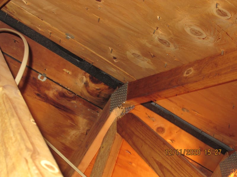

My fees for house framing are cheaper than most but I would never do that roof for $1,000. It would be $2,500 minimum and probably more. I used to be a carpenter, and I see numerous headaches with that many attic rooms combined with lack lack of continuity between floor levels. And you better hope they get a "custom house" quality truss supplier, not a "shade and shelter" quality.
Check out the shade and shelter quality I looked at last week. Both bottom diagonals pulled loose with just dead load and some light attic load. Looks like maybe 4 teeth in each one but at the edge:
