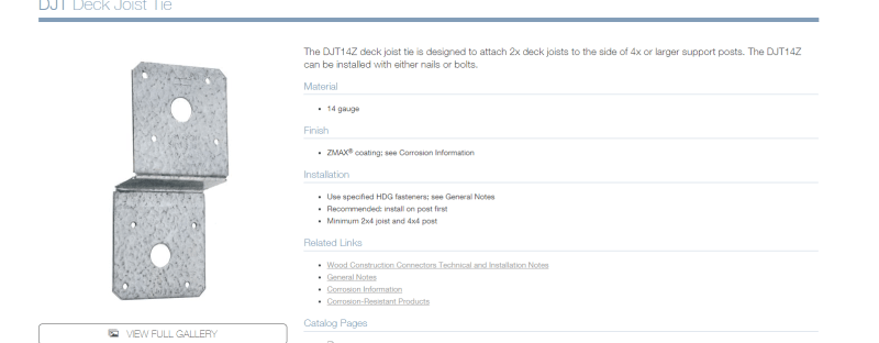

What about something like this?
It will require you to block out your column as there is only a 1 1/2" offset on the connector. But it may just do the trick. Depends on the magnitude of the uplift.
