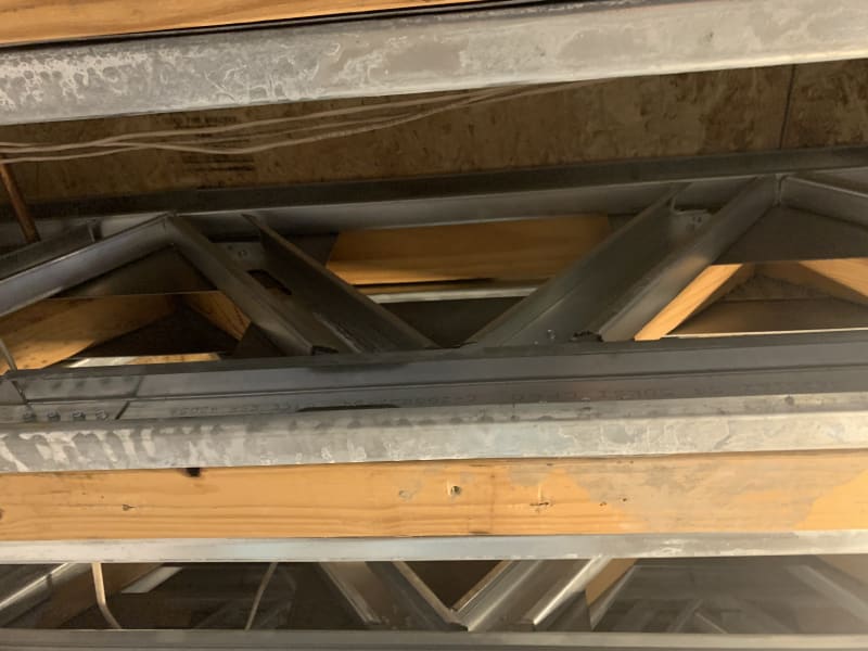

At this point, our plan is to site build light gauge steel trusses on each side of each existing truss. With all of the duct work, sprinkler lines, plumbing, and electrical running in the web space, we don't have too many options.

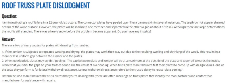

Yep. Some years ago (no "exact" estimate for the date this time [smile]) I tried to get someone [like Simpson] who makes them to tell me what they were good for in terms of loads (i.e. without any framing nails, etc; just the spikes). And they refused to do so.
Not sure about the edition from 25 years ago, but TPI 1-2014 is pretty informative. I haven't been through it in enough detail to handle OHIOMatt's situation, but I did review it enough to make me feel okay about metal plate connected trusses. know it isn't just a bunch of voodoo magic. Somebody did some actual testing to figure this out, and there's a way to calculate it.
ANSI/TPI 1-2014
Simpson has an ESR for their connector plates. Link
Sounds like this withdrawal type of failure is common.

My experience is that press plates don't "work" by conventional design calcs but rather they "work" because of testing and QC in fabrication.
fugeeo - Except for the poor joinery and possibly the fabrication (in this case) press plates are very standard for this application.
phamENG is right - It seems like magic but there's a bunch of testing and procedure/controls behind truss "design".

It seems that this is not an uncommon problem. Apparently the industry is aware of it, but cannot predict when it will happen. When the trusses were originally built, the joints shown in the photos were acceptable to the plate manufacturer. We are finding the problem extensively throughout the building. While we still don't know what caused it, we have been able to rule out the following:
[ul]Over Loading
Mishandling during erection
improper pressing of the plates
Non-approved fabricator
[/ul]
The suspect areas of floor have been shored. We have designed light gauge trusses to be sistered to the existing (we are actually placing one on each side). While we had hoped to just repair the joints, we found that the stress redistribution caused by the failed plates had actually broken quite a few internal members. It is a tedious and expensive process. The photo below shows the finished product:
