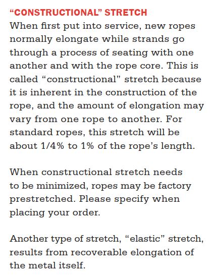

Page 30 of Jed's reference comments on modulus of elasticity:
BA
When the cables for the George Washington Bridge were being researched and developed by John A. Roebling & Sons Company (in late 1920's) - under the leadership of Charles Sunderland - they quickly realized that they would not be able to fabricate very long ropes to accurate lengths with accurate prediction of their tension-elongation behavior using current rope making methods.
When the working load on a rope exceed the tension used during manufacture of the rope, the rope compacted further and inelastic axial deformations occurred.
Sunderland therefore 'prestretched' his ropes to a tension load that exceeded their design working loads. The "Kinkora Prestretcher" was constructed near Roebling, NJ. It was able to prestretch ropes of length greater than 3,000 feet. It was a huge machine!
