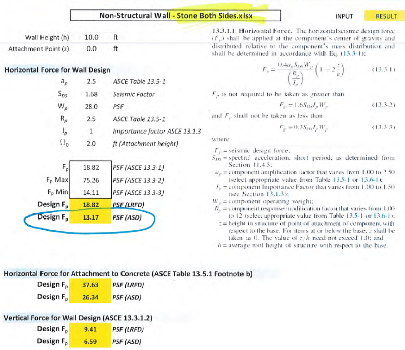

For an architectural free standing wall, I also look into seismic loads if the finish is heavy such as stone on both sides shown below.
