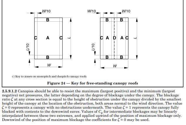

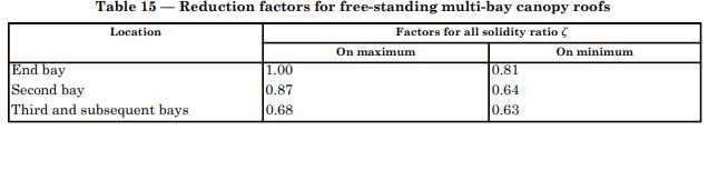

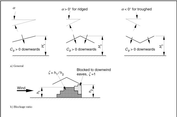

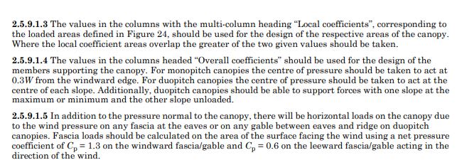

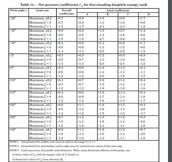

First question, you may refer to BS 6399-2 Wind British Standard (I added few screenshots).
Second question, the two cases are coming from enveloping wind tunnel results. ASCE 7 copy values from Australia/New Zealand wind code, British standard gives very close results. (Edit: remember those values for one direction only, for 90 and 270 degree, ASCE 7 shows different table FIGURE 27.3-7, the best to do to envelope results from both sources in each direction).
