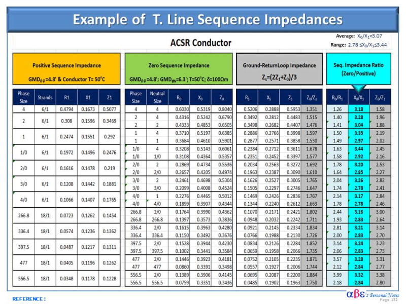

In the sequence diagram it’s 3Rf because the current through it is only I0. The drop across it needs to be 3I0 * Rf. That’s the equivalent of I0 * 3Rf.
This is because of the mutual impedance influence and the coupling effect with the shield ground wires and the earth.
Technically speaking, the factor of 3 is a rule of thumb that can be used in the absence of actual data with some sacrifice inaccuracy and uncertainty values.
Often the T. Line Xo/X1 ≅ 3 on average ranging from 2 <X0/X1< 3.5.
The table below is an illustration of various T. Line data indicating the impedances and ratio between the zero to the positive sequence impedance values.

Since nobody provided the full derivation for lines yet, here is the math:
check out the last matrix. Zs + 2Zm is the effective zero sequence impedance. while Zs - Zm is the positive sequence. Zs is self impedance, Zm is mutual which goes back to culky's table.

Hi MBrooke,
The impedance values on this table are for various line configurations used for distribution & sub-transmission tower & poles.
Should be noted as the voltage increases for HV and UHV, the relation still holds since the resistance to reactance ratio tends to be smaller as the systems voltage increases.

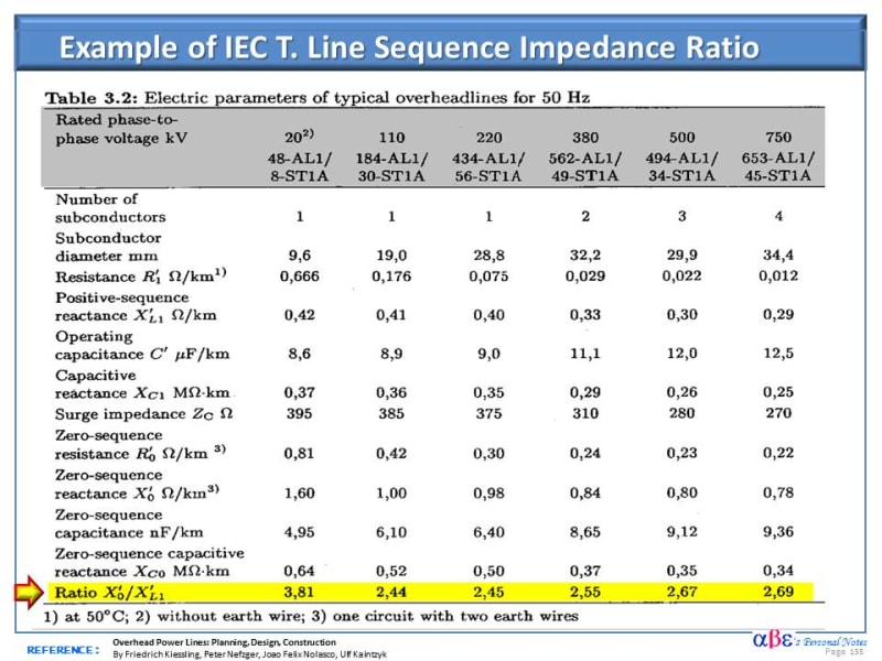

Below is another example of X0/X1 ration for various IEC tower configuration. It should be noted that the Xo/X1 ratio remains in the same range as mentioned earlier.
Two preliminary conclusions can be considered:
1) Appears that the X0/X1 ratio is less sensitive to the tower configuration.
2) It is also known that the number of shield wires significantly influences the Xo value but no X1, resulting in a higher Xo/X1 ratio as the number of shield wires increases.
