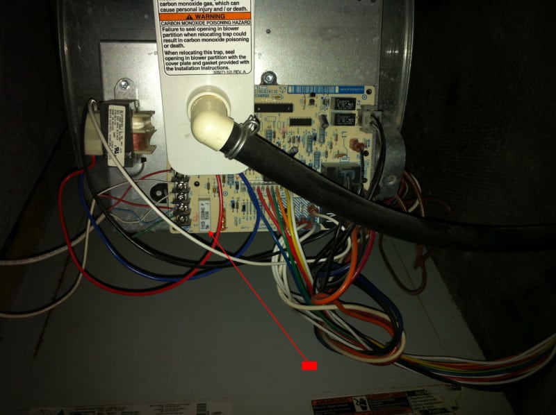

We are wiring in some additional discrete inputs on the HVAC system. Why does it require a 150 ohm resistor in the circuit?
Good question! Not explainable given the little shown about the inside circuitry and the fact that you remove a short to install the resistor and additional dry contacts.
Keith Cress
kcress -
Three states - Open = off, shorted = Ignore, and 150 Ohms = On?
Without that resistor when closing the other low voltage controls the voltage on the PTL would go to 0, causing it to stop working.
The resistor keeps a very small amount of current going to the PTL.
Best guess: To limit short circuit- and in the event the fuse gets bypassed. My own furnace has that same thing in series with the 5 amp automotive fuse.
Edit: never mind- specs say only 1/8 of a watt. Ohms law says 3.84 watts at 24 volts.
The resistor in my furnace is 510 ohms rated 5 watts, so that 1.129 watts. A dead short would protect the trafo and stop anything from catching fire.

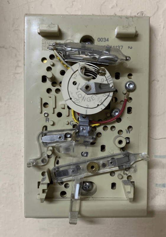

MBrooke:
I suspect that your thermostat has a small heating coil.
The pre-act coil is energized when the thermostat is on and acts to reduce the overshoot of the thermostat.
The resistor will limit the current through the pre-act element.
Many generic replacement thermostats have an adjustment to match the setting of the heater to the current of the furnace control circuit.
Bill
"Why not the best?"
Jimmy Carter
The circular line on the cream coloured disk is the heater element.
The wiper is used to adjust the amount of overshoot of the thermostat.
Bill
"Why not the best?"
Jimmy Carter
@Waross: Its an electronic thermostat, but this furnace model would also go into older homes with mercury thermostats like yours. I had the round version years back. I'd say you're right. Anticipator btw?
Anticipator
That's the word that I was looking for.
Thanks.
