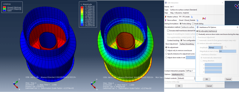

I have two steel cylinders which I made sure penetrate each other slightly, and then I tried slave adjustment to get proper contact, however this does not give full contact, only some parts are sticking and sliding while most of the area is open. I have no load, BC's, the step is dynamic implicit with moderate dissipation. The two cylinders should always be sticking. I do get sticking/slipping over the entire surface with interference fit, but I also get big displacements. I can counteract by applying BC's, but that is not how my BC's are supposed to be.

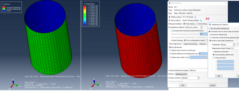

Uniform allowable interference fit:
Automatic shrink fit:
I tried doing another cylindrical model from scratch and got the same issues. I am not sure where to look for errors in my model any longer.
You can try refining the mesh properly and using different contact settings (maybe even general contact).
General contact is only available in explicit if I understand correctly?
No, general contact can be used both in Abaqus/Standard and Explicit. In fact, that's the recommended/default type of contact (because it's reliable and easy to use). General contact even supports interference fits.
Its just that I have to use Dynamic, implicit. Unfortunately I will have to find a way to make surf-to-surf work.
You can use general contact in dynamic implicit analysis as well. It belongs to Abaqus/Standard solver just like general static.
