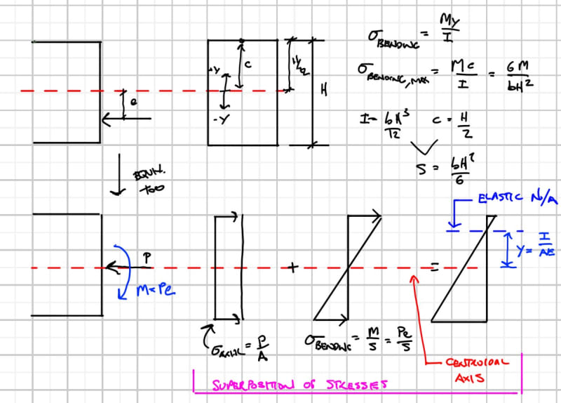

Hello I was doing a question in order to prep for the PE exam and I ran into this problem which I got wrong.
In this question since the cross section is being loaded axially plus a moment due to the eccentricity, that the neutral axis will shift from the centroid location. However in the solution they do not shift the NA why is this?
NA = zero stress DUE to bending (not zero stress overall)
I don't think this is right, but maybe different definitions of neutral axis are being used. For concrete design, my understanding is aligned with the diagram above.
I think this is all terminology semantics.
Here are my definitions:
Neutral Axis = Geometric Property where the first moment of area = 0 --> ∫ y dA = 0 or ∫ x dA = 0 (A Neutral Axis exists for any defined bending axis, the two formulas here are for the geometric x and y axis.)
Elastic Neutral Axis = Location of 0 strain of a fully elastic cross-section under combined actions
Cracked Neutral Axis = Location of 0 strain in a concrete cross-section after the extreme tension fiber of concrete has cracked
Plastic Neutral Axis (Steel) = Location where the cross-section is bisected such that C=T assuming the entire section is loaded in full yield stress in both compression and tension
Plastic Neutral Axis (Concrete) = Location of 0 strain when the extreme compression strain of concrete is at a code defined value (ACI 318 ec = 0.003)

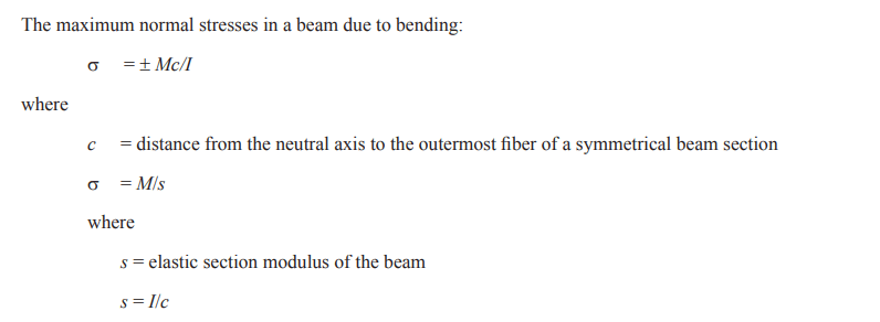

Hello all, I am a new poster here and a young EIT. I'm not entirely sure if my question should be a separate thread or not, but I believe it pertains to this topic so here goes. As I have been reading through this thread the top question that has been on my mind is when is it appropriate to use P/A-M/S vs P/A+M/S? In the PE handbook that the OP references it defines the normal stress as (+/-) Mc/I, but the usage of plus or minus isn't clear to me right now.

It’s always P/A-Mc/I, you take M as positive or negative following the convention in the PE handbook, and c is positive or negative depending on if the fiber you are looking at is above or below the centroid.
In the reference handbook the formula for sigma should be sigma = -Mc/I, as long as you are following the sign convention above. If you get a negative sigma that means that Fiber is in compression. And if it is positive that means it is in tension.
see that's where I differ ...
the stress equation is Mc/I ... +ve M and +ve c give +ve stress (by definition).
but in practice we're more interested in the compression stress from bending, so we write -Mc/I.
and then "c" ... using the furthest extreme fiber is correct for symmetric sections or sections with reversed bending,
but conservative for unsymmetric sections
