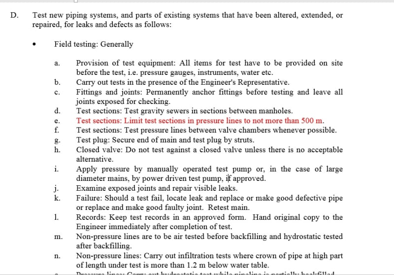

The standards mentions that the pipes pressure tested should be no longer than 500m.
However, I have installed pvc sewer mainforce line more than 800 meter without conducting pressure test.
I just wanted to know, technical what will happen if we conduct pressure test for pipe length exceeding 500m.

You are right.
However, our project specification has mentioned:
e. Test sections: Limit test sections in pressure lines to not more than 500 m.
(img ]
I thought this is specified in some standards. However after going through ASTM F 2164 and AWWA i was unable to find any upper limit for pressure test pipe length i.e. "< 500 m".
May be it is only our project specification and not standard.
Thanks for pointing out the point.
The only practical limits I would consider is a small leakage rate on a large diameter pipe won't show much pressure loss with longer lengths having more volume. For small diameter pipe would frictional head loss play any role in equalizing.
