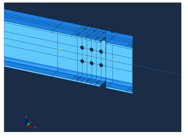

Hello everyone. I have some doubts about modelling in ABAQUS 6.14 a connection between a wire beam and a solid element (the other part of the beam, where I need to have a more accurate response):
Which kind of constraint could I use? I was thinking to give a coupling between the face of the soild beam and the external point of the wire, but I don't know if that's the right choice. Thanks in advance.

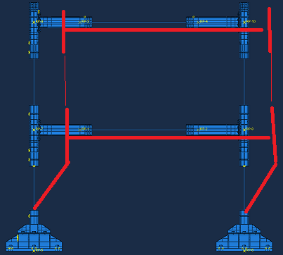

The part I evidenced in OP picture, is part of a 2D two-storey frame, so it's not a very simple model to run:

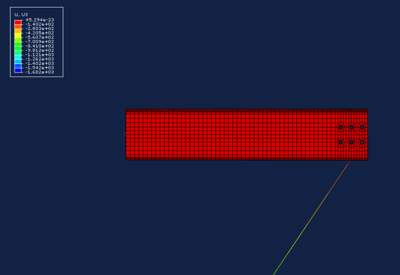

When I tried with MPC (tie type) connected directly between the various solid elements and respective beam elements, the analysis succesfully finished, but the displacement was definitely strange, because it was a thing like this:

I think Erik meant to move coupling away from the holes (since they are stress concentrators) by adding another part of non-performated solid beam between perforated part and wire beam.
Make sure there are no errors for example with the wire beam cross-section. Visualize it in the Assembly module. Also check its properties.
See below - pardon my artistic skills but I think it should be clear (so do this if holes are the areas of interest where highest critical stresses would be expected, and you want to capture that)

3) MPC Tie → Strange deformed shape:
Of course something wrong
