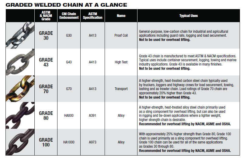

lk_hjlihli_lihlhjj_jkl_j_l_jl_jk_l_jk_k_kjlwkj_lqjklkf_jwlkq_jkefl_qw_k_kjefjjkhfkjhgkjlhdkshgkjdlfs_pacori.jpg
[wink]
MJCronin
Sr. Process Engineer
Oh Yes. Perfectly obvious now that you mention it. I believe he was yanking OUR chains.
Sometimes sarcasm can be hard to recognize without a [wink]
Reality used to affect the way we thought. Now we somehow believe that what we think affects reality.
Yes. It is true. None of that is approved for pipe stress. [wink]
